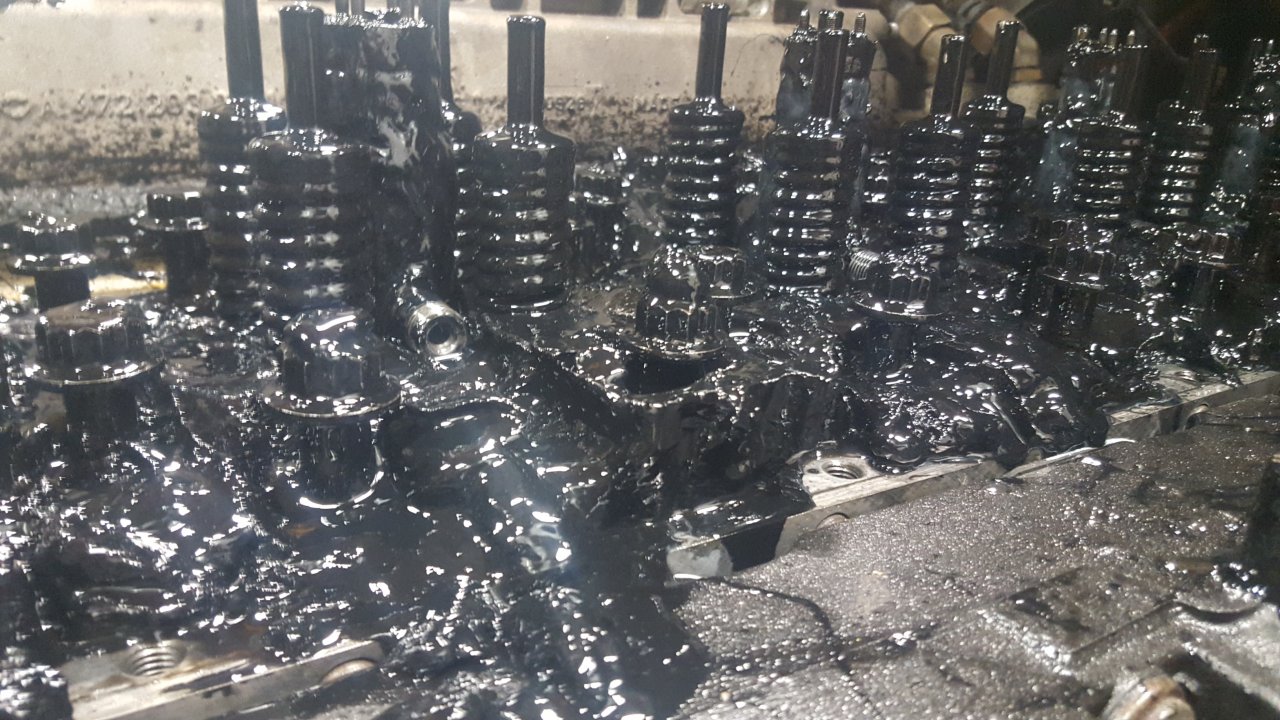

    It came in for coolant in the oil due to a failed liner. But I feel like there were problems long before that, we have a lot of cylinder kits and never has the oil been that thick, usually the coolant separates to the bottom and it just drains most of the coolant out of the pan and then oil. Really not sure how they let this happen, it was from a major fleet with a few goldish colored trucks ;). They somehow got Detroit to cover it under warranty even though is was clearly neglect. Ended up buying a hazmat suit to pressure wash that engine. They wouldn't pay to remove it and send it to be cleaned, ended up coming back a few months later for another kit. Miraculously the bearing were all fine.
