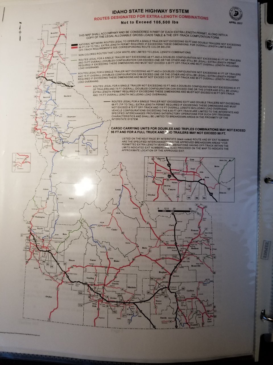

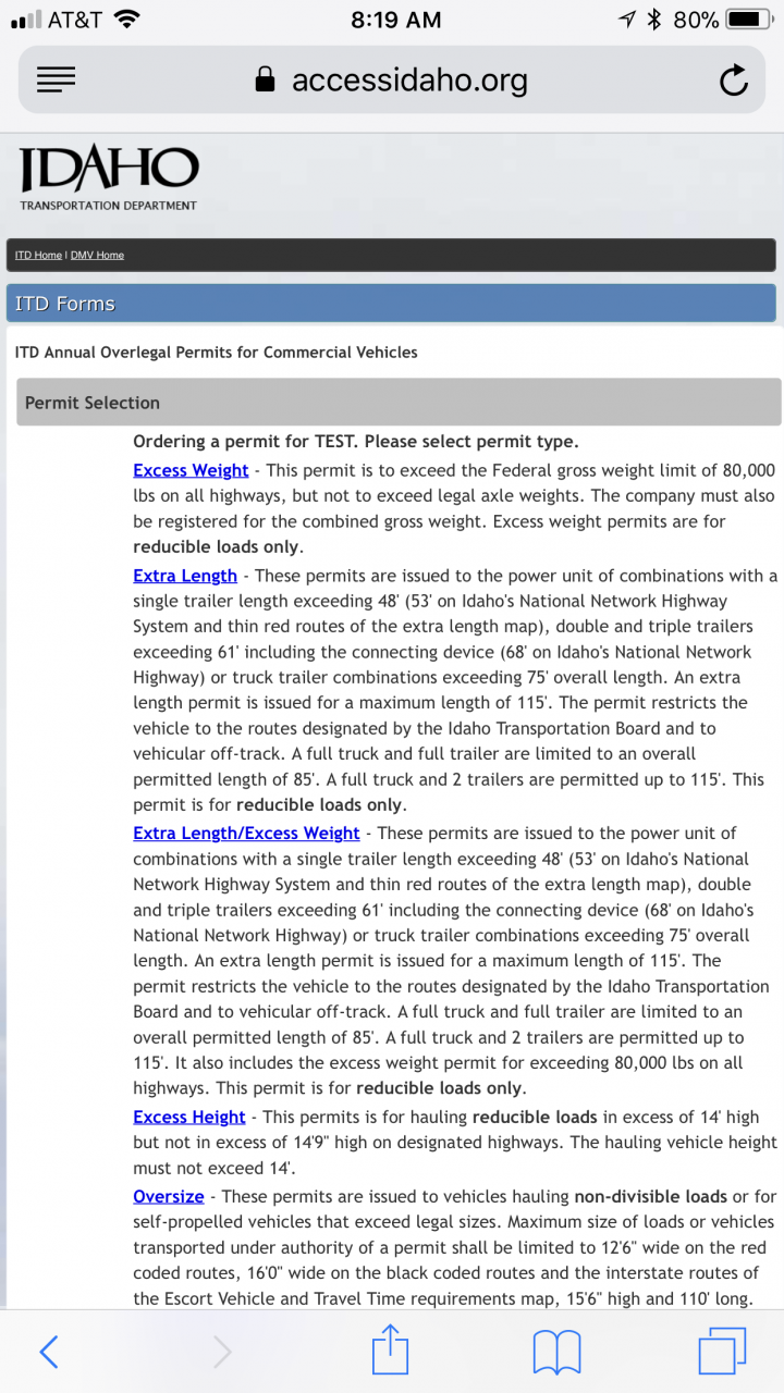

    Depends on how far off the beaten path you want to get. National Network routes don’t require a permit, given you’re just running 80k gross. If you’re going to run heavier than that or get off the National Network routes with a trailer over 48ft long then you’ll need a weight permit or an off track permit or both.

    There are some permitting requirements for Idaho depending on your route. If you have an IFTA sticker you're good on fuel permits, but there is a temporary commercial vehicle permit as I recall. It was around $50. You might want to check online before getting there and check it out. I seem to recall the permit was only required on one of the interstate routes through the state, but not all of them. It's been a couple years since I've been there.

    Here’s what you would need a permit for. Without you saying where you will be going it’s tough to make a blanket answer on if you need a permit or not.
