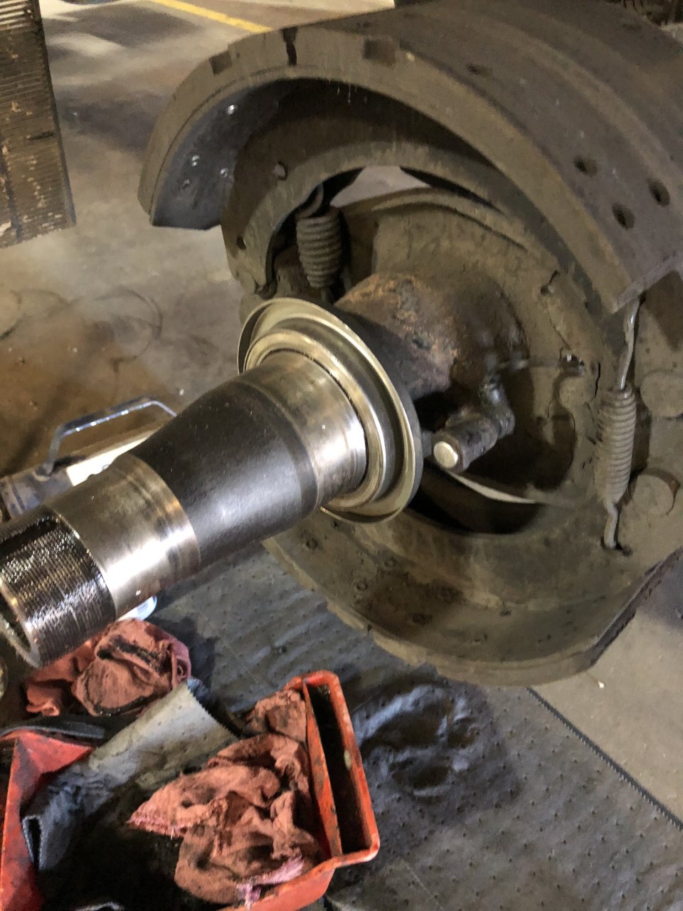

    460554F0-5BA7-4168-9EF3-C104AD9AD3F9.jpeg Well I got an update here. We went with the two part stemco seal with the wear ring. We drove the wear ring on, then put rtv silicone behind the seal/between the seal and wear ring. Did the torque down process.
    I’ll try update this every three months or so with results. Thanks y’all for giving me more of a leg to stand on when going into the shop.

    Looks like a well used wear ring installation tool in the picture, the blue can with a handle. A little sealer on the spindle before the wear ring is fine. A little sealer in the hub bore or seal OD, fine. I do mean just a skim. Sealant between the seal lip and wear ring should not be done.
