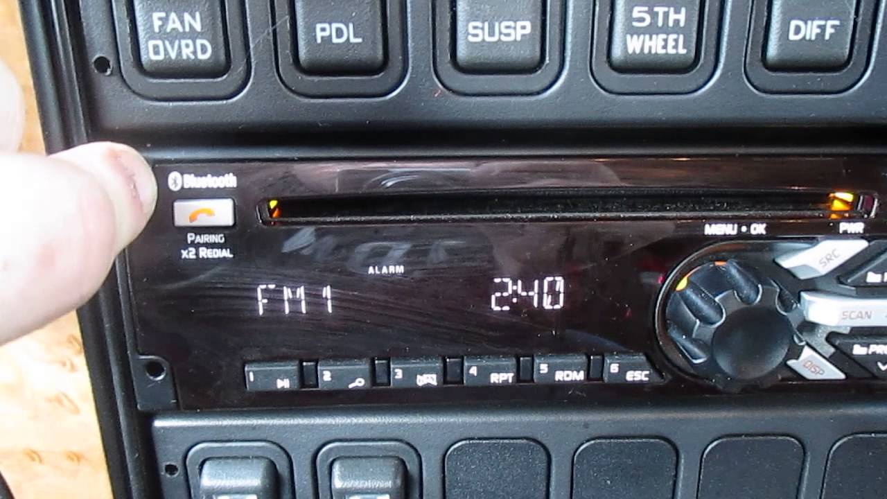

    Anybody know how to set the clock on a 2015 International? I'm talking about the radio clock. It's the one that has the Bluetooth pairing option, radio that is.
    I usually can figure these things out but this one I'm not able to so far.

    push and hold the big black knob, menu will appear will be something like 1/7 or 1/8 turn knob to go thru menus, bass, mid, treble, balance, fade, eq, clock, alarm clock, push again to desired menu

    I'm not at the truck now but I'll give it a try when i get back. I could have sworn I've tried that several times and never saw clock as an option..bass, tremble and all that but not clock.. weird..

    while radio is on, push the big button(menu/ok) will say bass 1/8, scroll to clock 7/8, push button 12/24 hour format, push button again, clock with flashing hour, turn the big button and push to set time

    Yep that fixed it. I can now look at the radio for time again. Can't believe I missed that before.. thanx again.
