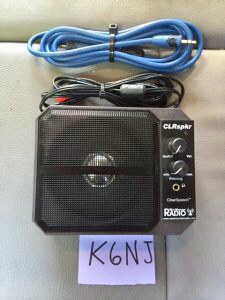

    1). The basic radio (don’t buy lesser) would be a UNIDEN 980. AM/SSB. $150
    2). An RM ITALY KL203 amp. $75 for 75W. Will run on same circuit as radio (15A).
    3). West Mountain Radio ClearSpeaker. An adjustable DSP circuit clears the noise. No CB or Export Radio has this.
    $200.
    Getting out is great. But hearing what the radio by itself can’t clear up is superior.

    I have been looking at the Clear Speaker thing for a few months. Someone on here recommend it a while back. I just haven't been ready to pull the trigger on it yet.
    One question, do you have to provide power to it as in an external 12v source ?
    Slowmover1 Thanks this.
