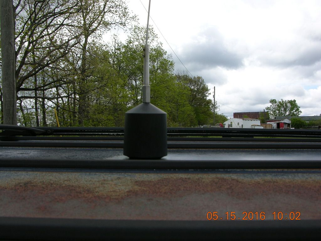

    hard to beat this[​IMG]
    wolverine11 Thanks this.

    You got that right RP, my F150 is 11 years old so I should just do it right and drill a hole and do a permanent roof mount right smack in the middle where the 1000 mag mount currently resides, you cant beat that setup.
    rabbiporkchop Thanks this.
