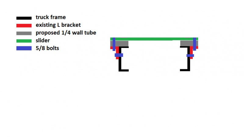

    i need a tall 5th. my 5th wheel slider is the style with a L bracket mounted to the fame and then the 5th wheel slider bolts to that flat with the top flange of the frame. i was thinking of buying some 1/4 wall rectangular tubing drilling out the bolt holes to match the slider and bolting it in under the slider. any reason not to do this? i would probably box the ends as well to keep the dirt out of the tubing. i could also drill out the holes bigger and weld in 5/8's ID round tubing in the bolt holes to make it stronger yet but i don't think that would be necessary.

    in case anyone is having trouble visualizing from my disciption

    Using tubing I would worry about it crushing and the bolts coming loose that would be a rejectable condition and if the tubing is distorted that also would be a rejectable condition.
    You could just cut out the stops at the back of the deck plate and replace the slider with a taller one, they make them in a lot of different heights.

    That' what I did on my last truck, raised the whole slider assembly. I used 3" X 8 " 1/4" wall tubing & boxed the ends. I think the bolts that hold the slider on are 5/8" so when I drilled the holes in the tubing I drilled them just big enough to put 5/8" ID bushing stock in them. Never had any issues & did it for under $250.

    did one like your saying it worked good never had any trouble working lose or with DOT, but the next one may turn double back flips when he see's it, you know how that goes. DROY that's on here sometime told me ergon wouldn't let them pull a tank like that.Seen beenjammin's post might not be good idea anyway

    Don't see anything there that would prohibit a person from fabricating their own riser, so long as it meets the standards called for in the regs.

    I don't see anything that says you cant make your own. it says "properly designed" " tightened bolts of adequate size and grade" "The installation shall not cause cracking, warping, or deformation of the frame"

    It would be way less effort to just get the proper legs for the fifth wheel. They make then in all diffrent hights. Go to local truck salvage and buy the correct one.
    Look much more professional and proper.
    Just blow the stops off with a torch, slide old one out and slide new one in. Now would be a good time to put a kit in your fifth wheel while it's off. Done!
