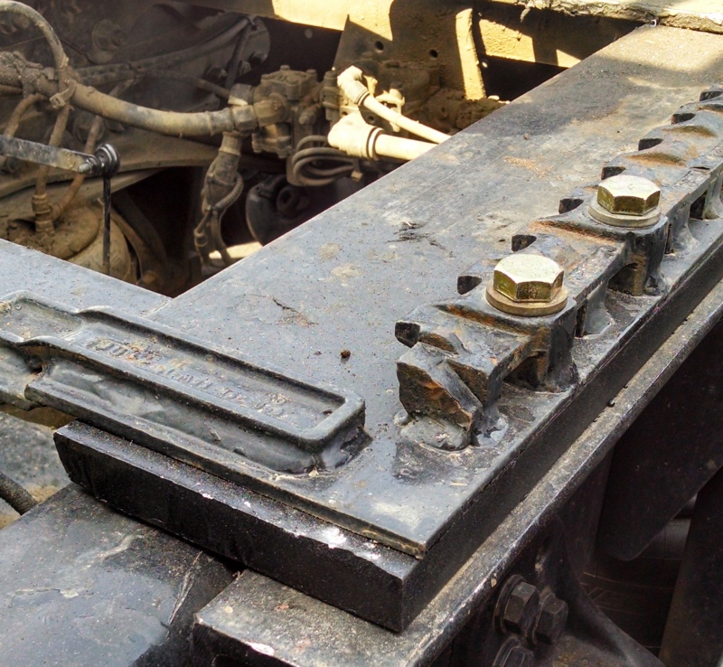

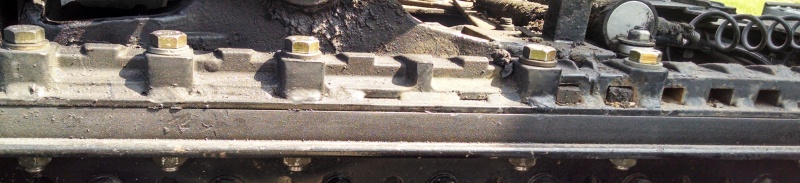

    I used 1"x6" solid steel bar, and drilled 9 holes per side and got longer grade 8 bolts. 18 - 5/8" diameter bolts all told, so have more than enough shear strength me thinks...If a naysayer or a DOT cop want to argue, look up the strength of a 5/8" diameter grade 8 bolt and get back to me.
    If your 5th wheel is like mine, do this. The hardest part is drilling the holes, but it is MORE than secure enough. And as far as getting used 5th wheel stuff, no thanks. A new riser assembly for mine was $775, no labor included. Ripoff.
    The steel and bolts were under $300 all in.
    I wouldn't use any type of box section to raise it, I wouldn't trust it for overweight loads myself, but to each their own on that.
    Post a pic of your 5th wheel setup and I may be able to make some suggestions.

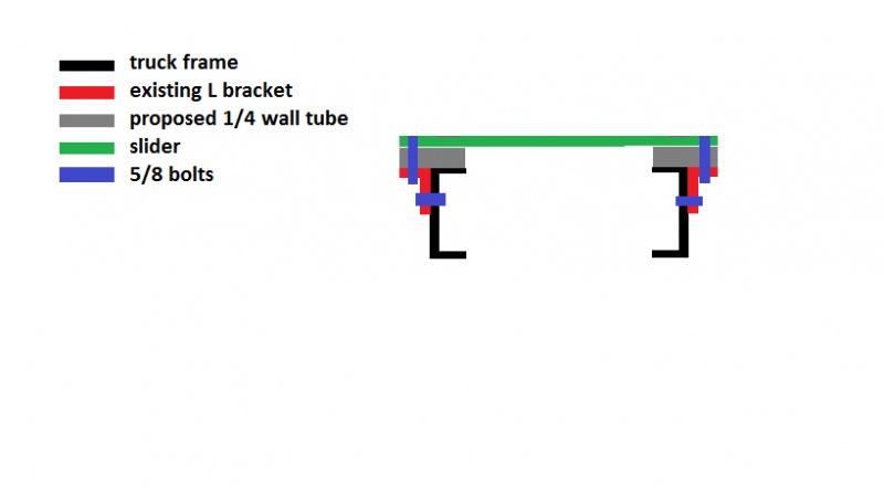

    mine basically mounts the same a little different style though
    here is a Google image of my style slider. but mine bolts down threw the top into a L bracket like yours ill take some pics of mine when i get a chance im going to need more than 1 inch so i think solid steel isn't going to be a option. i don't run as heavy as you probably do but not light eaither 96k gross

    Looks like a well thought out plan to me. There is no issue doing it this way. Sure you could replace the legs with taller ones, but what you have here is the same result, but better IMO. If you ever want/need to lower it back down, it's just a matter of removing the spacers and using shorter bolts. The round tubes will prevent crushing and keep the bolts tight. Just check the bolt torque bolt torque a few times after some load time.

    Last one I did was basicly just what you showed in your picture, I use 5/8 grade 8 bolts with stover lock nuts and 3/4 " heavy wall pipe welded in to transfer the bolt load, the Rectangular tubing was 3"- 1/4 wall and the width of the frame flange and the mount angle, this was for an Alberta heavy haul tractor with a high load fifth wheel, taller risers were not an option. almost All oil patch winch tractors have their wheel mounted on a 3" sub frame. If you make the back ends taper and seal the front, it will look like manufacturer option.
