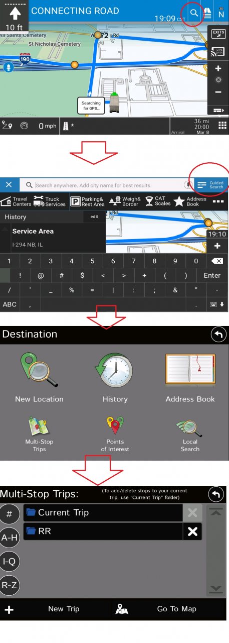

yes,
please see the attached image for the steps, i hope this is what you want to do.
it is a very good question abut the UI design though.

	Btw, where is the 'trip' folder UI (without using 'file manager' to check)?
 thankstscottme Thanks this.
	Tap your multi stop icon and you’ll see current trip
	Thank you very much.

 which model that you can easily access the Muilti Stop icon?
 RM has many models and different UI to learn.
	My question was about the RM740. I used the pics he posted.truckpc Thanks this.
	thank you, my question was for
 billindelicato
 since he said there is a Multi Stop button/icon to click, which you did not see it. Some Models, the 'menu' button takes you to the new UI's preference settings
