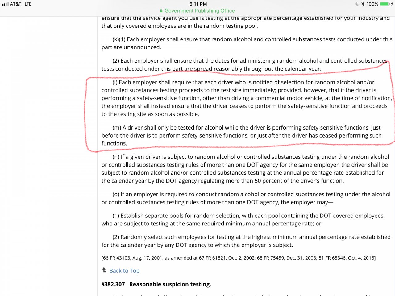

    Not a valid random when you've been off duty. Unless your company doesn't care whether it's valid or not.

    Notice that it says 'Quarterly' in the heading, which means that your 'selected employee' needs to test before March 31st. Your consortium doesn't care how timely you are as long it's by the last day of the calendar quarter.

    @brian991219 may be able to help on this.
    I would have to dig through the book, but as far as I know you have to test after performing a safety sensitive duty like driving. What qualifies as reasonable time I have no idea.

    382(m)

    I forgot everything is online now. These two here are your answer. 649C94F4-983C-438E-86D2-215B3A5D281B.jpeg

    Nothing happens and you have nothing to worry about. Get it done whenever you can get to a facility.
