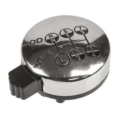

    I put old school Fuller Roadranger shift knobs on all mine with 13/18 speeds for nostalgic feeling, and to keep a small piece of history at hand at all times. Only thing I have left, lol.
    My 1978 and 2000 W9's have the chrome domed splitter and the separate hi-lo range switch on the side. I bought mine off Ebay, probably knockoffs but they've been fine for a few years in service so far. I do keep a spare on the shelf just in case. If I remember right, the splitter is about $32 bucks, and the hi-lo switch was $17.00, so about $60.00 shipped to the door total. I priced them for fun at Peterbilt store once, the splitter itself they wanted $80.00 for.

    Oh so pretty.
    Take me back to my 13's days. Oh the Nostaglic... whoo..

    My red and black 359 came with a RTOO14613. It came with the 3 position knob like you posted. Killed me when the slave went bad and couldn't get the 3 line anymore. I had to update to the new style.

    I would like to get one like that, but if I remember correctly, the splitter only knob had a picture of a globe on and said "Road Ranger".
    I've thought about calling Eaton to see if they have any NOS. I would, if forced, get a knob like yours, but not splitter/range knob.
