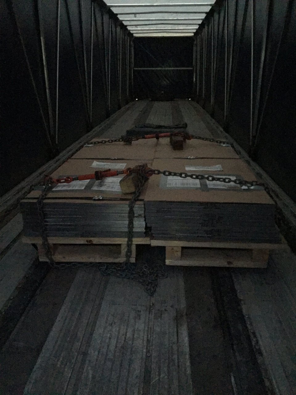

    Here is an example of putting a block f wood under the ratchet hook to lift it off the plate.

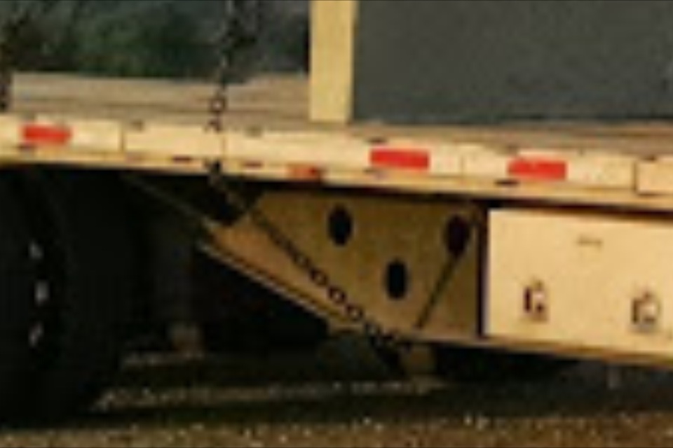

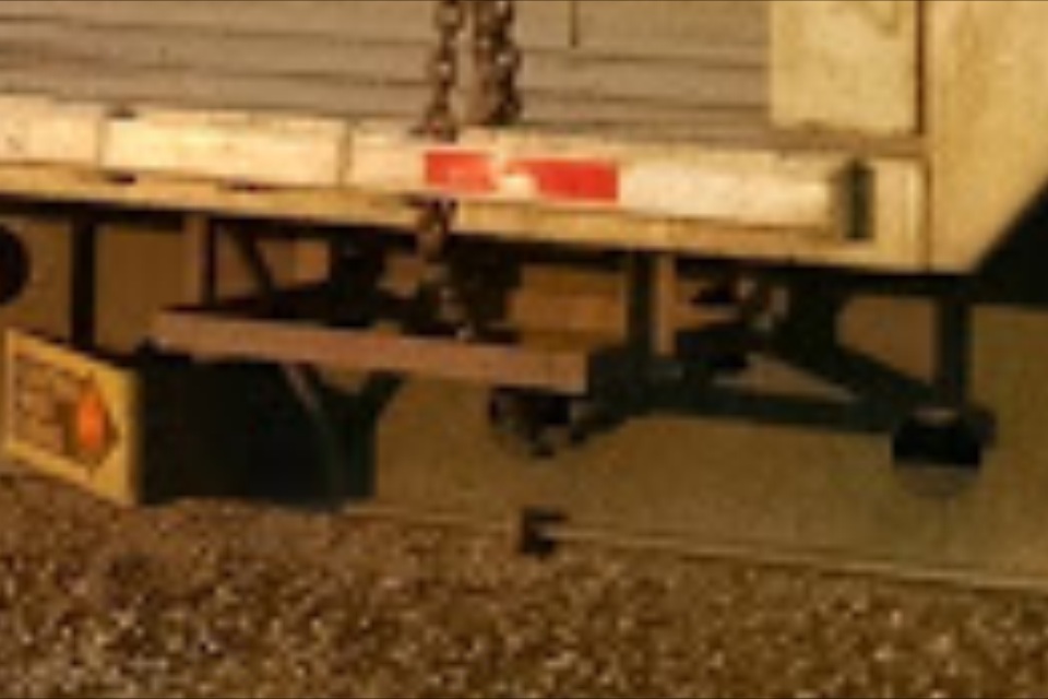

    I"m talking about going through the rubrail to the frame of the trailer underneath. If it's possible for the frame to be hooked to.
    None of you guys are carrying 8 inch RR ties. So how do you secure a load that only has securement points UNDER the load sitting on 4 inch dunnage or not if the case may be????? Specially you guys that don't carry snaps, only ratchets.
    You can't strap OVER the load as you'll bend the top.
  4. skootertrashr6
    skootertrashr6 Medium Load Member
    639
    6,942
    Jan 4, 2012
    Pueblo, Co
    image.jpg image.jpg If you zoom in on the load, you can see his chains that come down the sides do go through the rub rail and are hooked to the frame, in the 2nd pic chain goes through a cutout in frame and can see the hook under the cut out hooked to frame

    yep, sorta like that. Looks like that dude still has chain in the open though. The load i had, was a box van. The securement rings were 3 feet inside the load, underneath.
