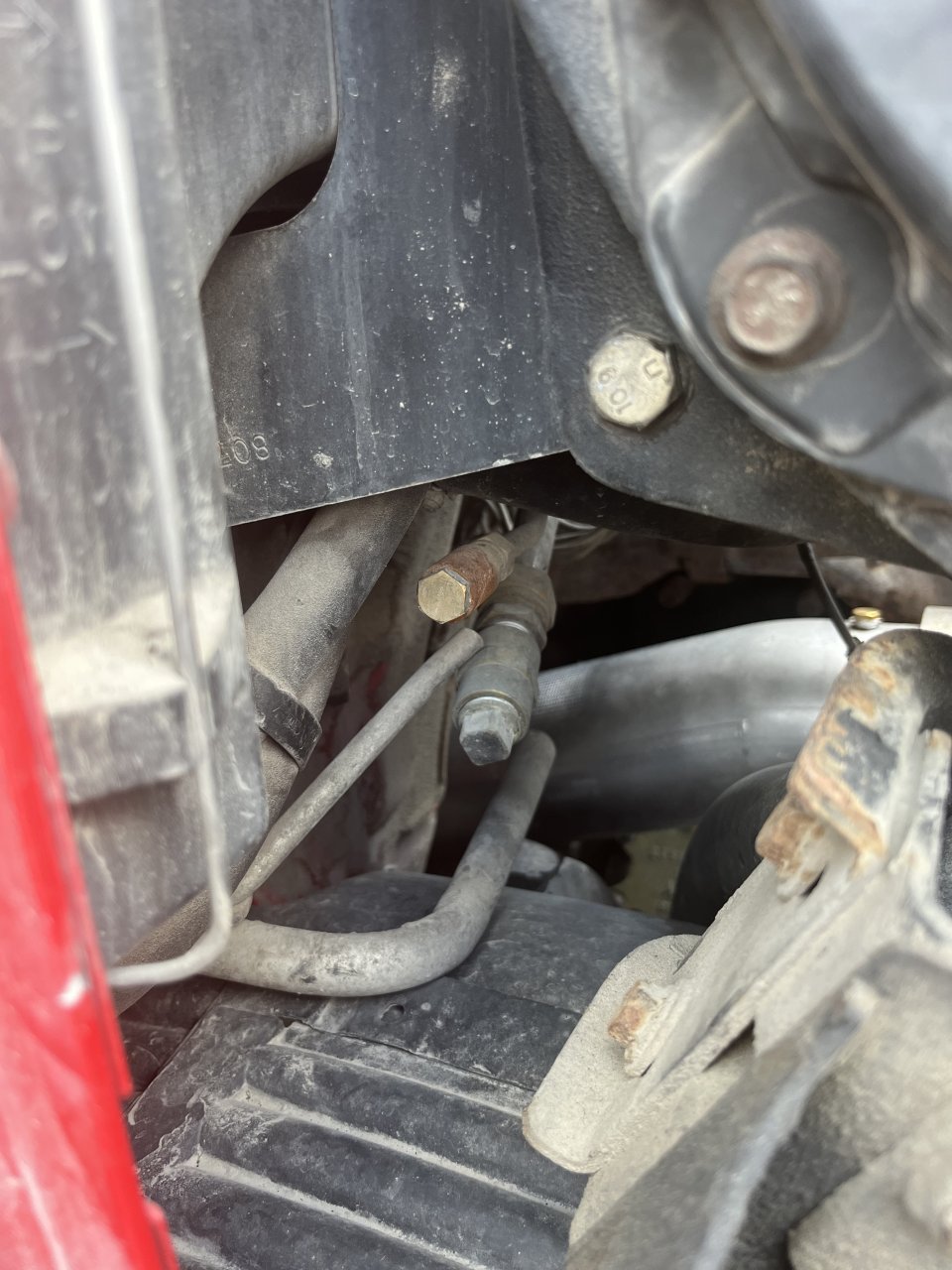

    Looks like somebody cut off ac lines going to rear,rear ac blowing mild air
  3. boneebone
    boneebone Road Train Member
    2,297
    2,372
    Mar 13, 2009
    Yep, that’s what it looks like.
    You”ll need to install new lines if you want A/C in the bunk.
    ducnut and DUNE-T Thank this.
  4. DUNE-T
    DUNE-T Road Train Member
    7,058
    17,201
    May 10, 2015
    Detroit, MI
    If they are seized in the rear, sometimes it's almost impossible to unscrew them, so some people just cut the lines to avoid costly repairs
  5. Rideandrepair
    17,578
    56,941
    Aug 8, 2015
    At least they still have fittings on them. Should be able to get new lines. Factory line sets are very expensive. My Freightliners over $1000. They’re a combination of steel tube and flex hose. I had some made up, ran flex hose all the way. Much cheaper.
