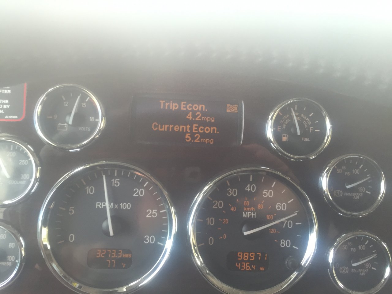

    You lost 300 rpm with one shift on an 18 speed?

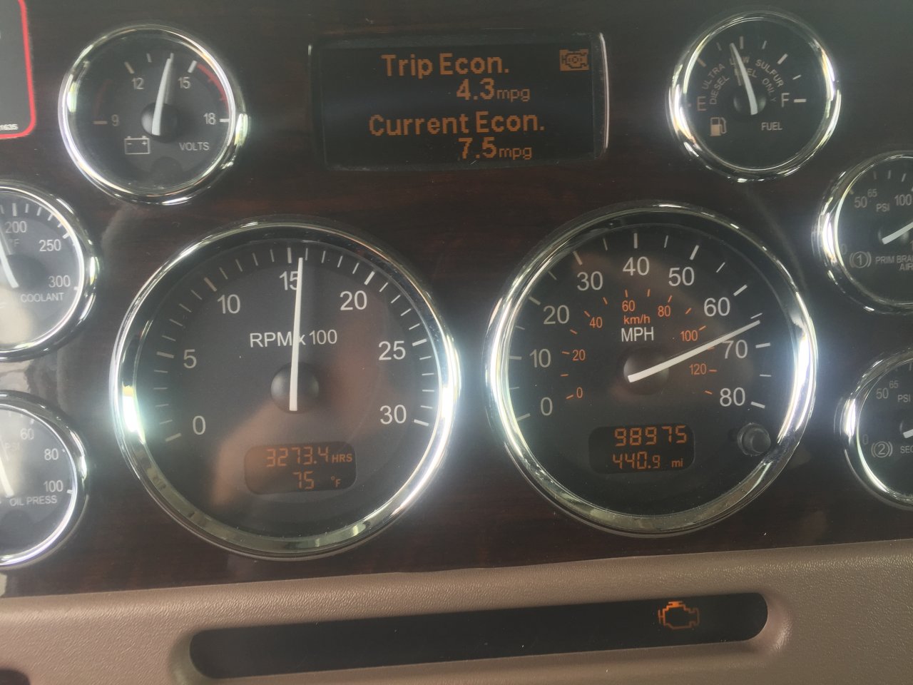

  9. Roberts450
    Roberts450 Road Train Member
    2,237
    3,638
    Feb 6, 2016
    Pretty close it looks like.

    I only lose about 250 RPM on shifts with 18 speed and 2.64 diffs on low pro 22.5 rubber.
