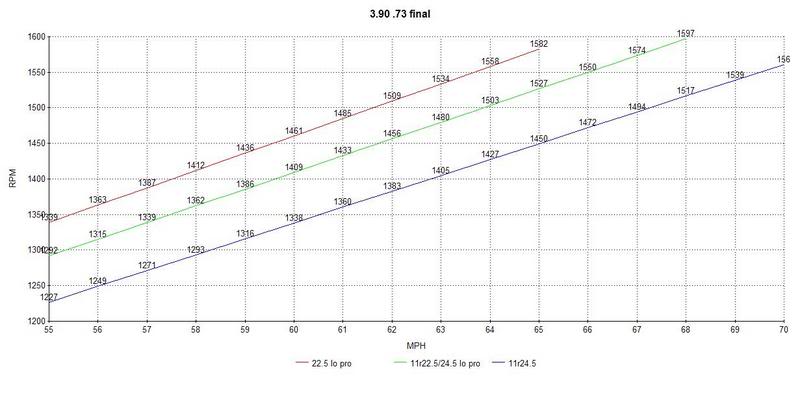

    I'd think for that kind of weight a 18spd with a 3.70 or 3.91 would be pretty sweet.

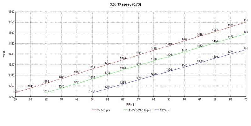

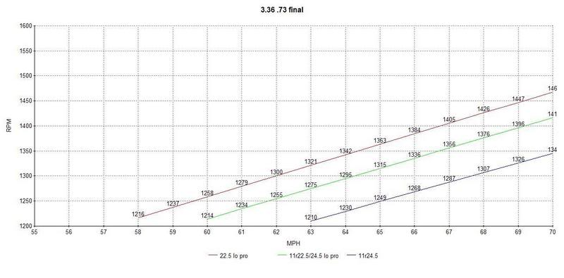

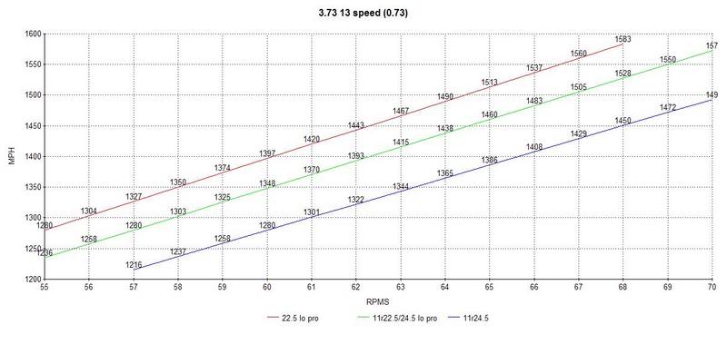

    Here's some charts I made many moons ago:

    I think running fuel efficient 22.5LP tires with 3.73 gears at 63-65 mph would be a good compromise here. Engine RPMS would be 1340-1370. You would gain easily .7 MPG if not a full MPG over running whatever gear ratio with 11r24.5 tires at 70 mph. Plus it will be easier on the driveline and driver.

    18 speed, 3.73 rears and 24.5 tall rubber. Works good hauling heavy in the northeast but your FL runs not so much. Your looking at a compromise here!

    But you are assuming that one is always in double over (.73) in your charts. Why? What is the mindset that says one always has to use each and every gear available? Why couldn't one just use the first over as their top gear? Heck, we had single over 13's and 18's in the past. Just because they all come with double over's now doesn't mean we have to use double over. Make up some charts to show single over (.86) and how it would look. Then the 3.36's are not that big of a deal. Most do not use all the gears on the bottom, why would they always need to use all the gears on the top? I never use the top two gears in my setup, and have never had any desire to. But I have used every gear below that at one time or another.
    I use a road speed calculator spreadsheet that I can plug any tire rotation, tranny gear ratio, and rearend ratio in to, and it will give all the speeds from 1200 - 1600 rpm. I can change things on the fly and get new values. Using .86 hooked up to 3.36 rears on low pro rubber, the road speed at 1400 is 56 mph and 1600 is 65 mph. Direct drive is 49 mph at 1400 and 56 at 1600. Seems like plenty of room to work to me.
