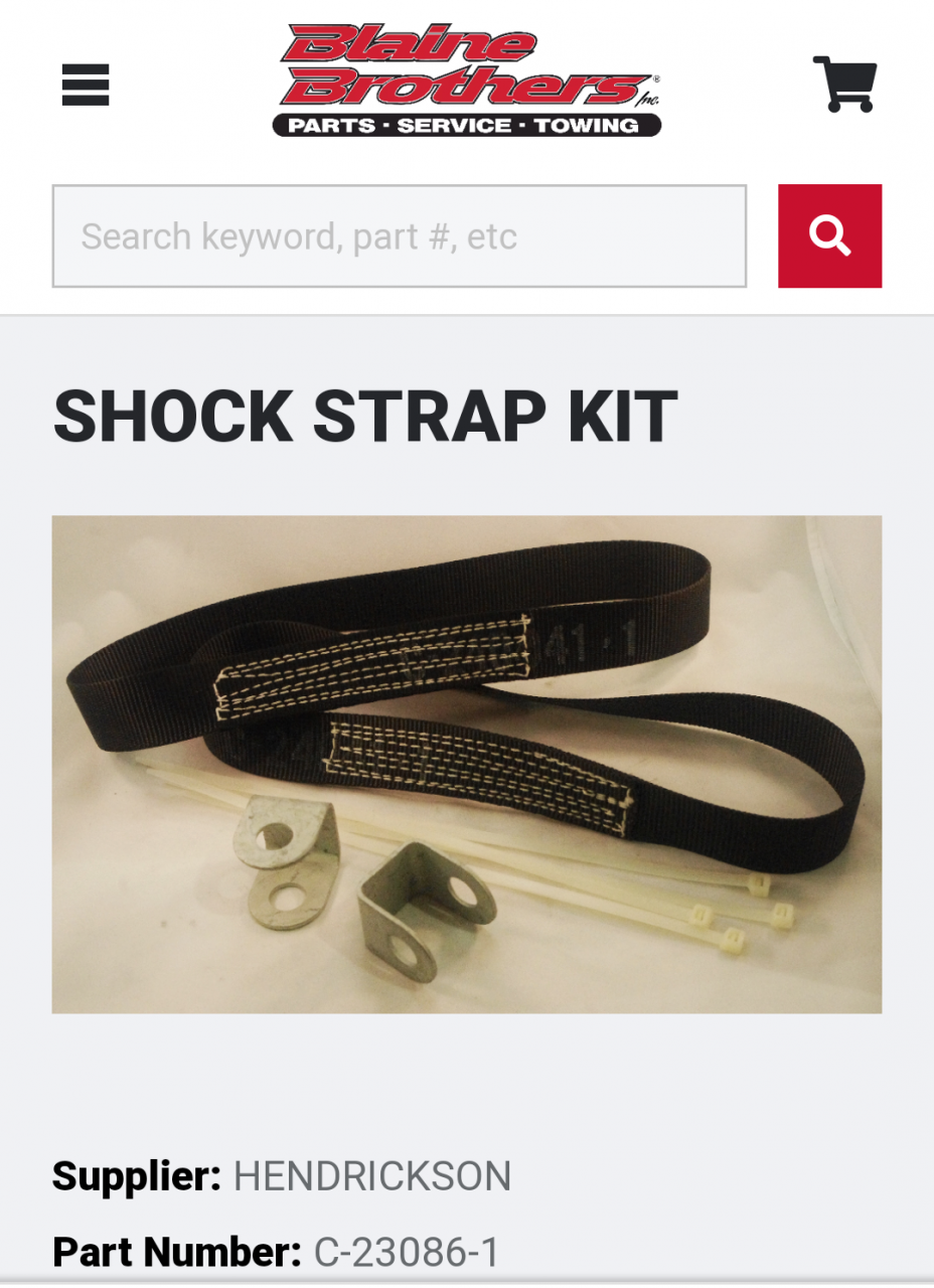

    On our trailers with high lift switches for the air bags, they come with these on the shocks.
    But as said above if OP has wrong shocks/air bags/adjustment, they would just be a bandaid.
    cke, Heli-truck, Rideandrepair and 4 others Thank this.
  11. IH Truck Guy
    4,947
    57,447
    Mar 2, 2008
    Purgatory
    Most of our trailers have these.
    Prevents alot of damage when lifting the trailers with a crane to deck them up.....
