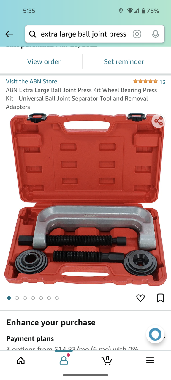

    I don't know a good way to share a Amazon link here. So see the attached screen shot. Also if you search "extra long ball joint press" on Amazon it is the biggest one. The opening is 11.5 inches. It is made by ABN. I will report back after I get everything fixed and let you know how it worked out. Supposed to arrive Friday. Based on what I accomplished with a much small press I am optimistic this one will work.

  6. Rideandrepair
    17,584
    56,957
    Aug 8, 2015
    Good deal. That’s the one. Looks like it should work.
