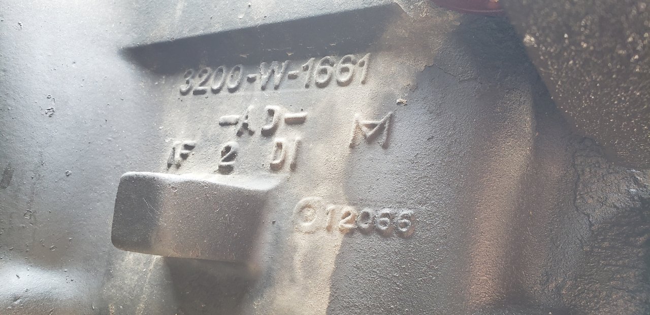

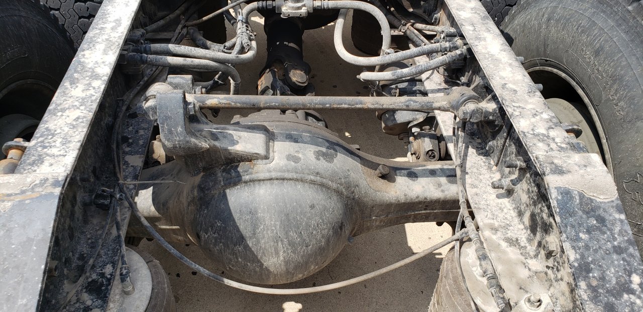

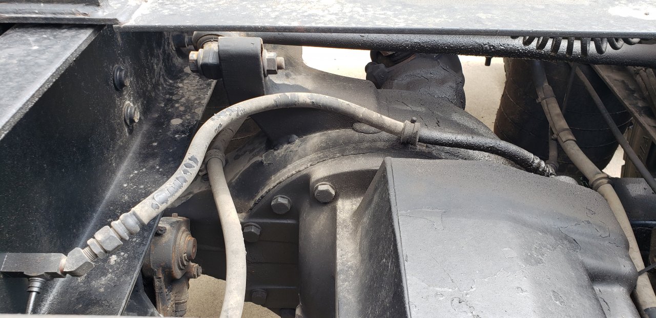

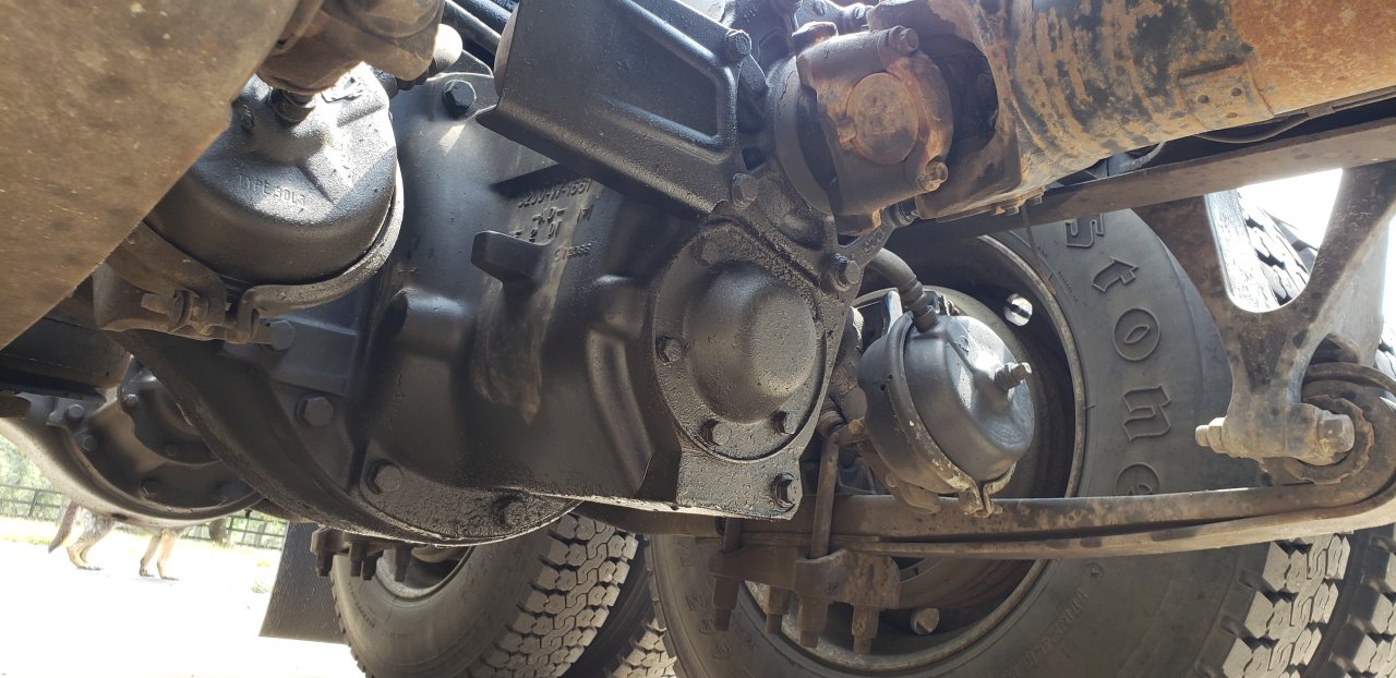

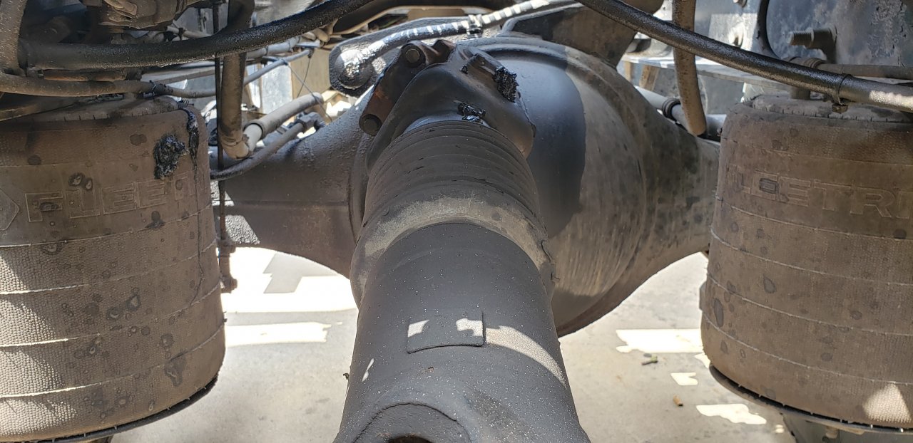

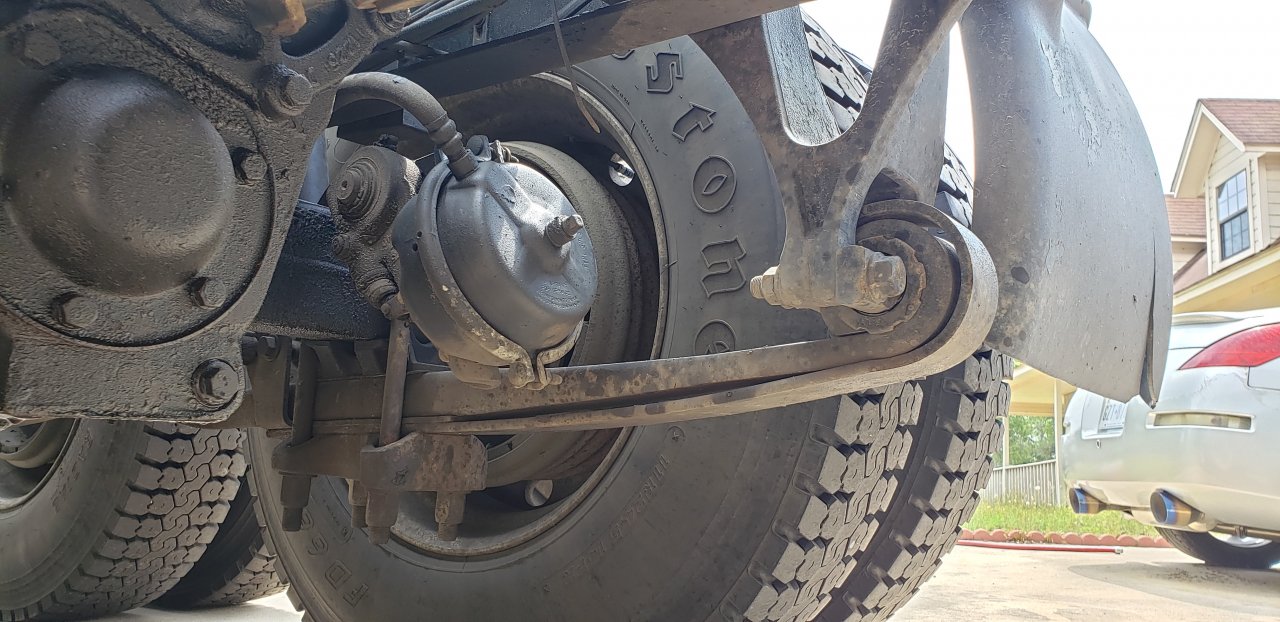

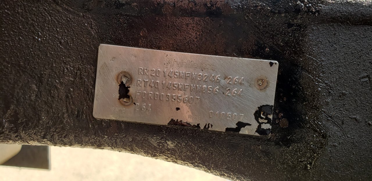

    I have Meritor axles. I'll post pics of the data plates from my phone. I'm getting input and output shaft pinion seals and new nuts. Just want to make sure International is getting me the right stuff. For example, one of the nuts they're getting me is a 40x1234, but the parts breakdown shows 40x1233 and 40x1237. Not sure if there's a difference.
    Do you know the correct part number for both seals and both nuts? Also what size sockets do I need? I want to get the sockets lined up before I pull this diff. Thanks.
    Also, are these axles worth AF? Are they "ole reliable", or are they problem-prone?
    Edit: For clarification, I'm only doing work on the front end. Pulling the diff to reseal it, and need to replace the front pinion seal. Since I have to pull the rear yoke, I'm going to do both seals while I'm in there. Sick of gear oil getting all over my truck and trailer.

    Couldn't make the tag clearly but ,looks like 40's , on hockey stick .I'm in the process of downing a set and checking them out (3.42), pulled the front stump and replaced oil feeder plate to the bearing . Can't remember the seal #'s off hand but , I keep a log on each component repaired or checked such as bearing #s, seals. You may have to get a mm socket to fit , I think that I tried sae and wasn't it. I do remember that I used Seals ( #'s won't match yours) that didn't require a ware ring so I pulled the ring off, if your ring don't have a deep grove worn in it , you can just replace the seal. Rings are on the yokes and the original will also have a dust ring made with it. I'll try to get a size for the nuts , I reused the old ones , they was locking style.

    The seal I installed was national # 100494 ( 3.253x4.249x0.635 ) input ,remember I pulled the wear ring . Industry # r945007 seal - input nut 2.20" and output nut 2.150" you can invert this to mm so you'll know what size sockets you'll need . I think I used a 2 3/16 " on rear but had to get a mm to fit the front yoke nut, yours should be the same but , don't hold me to it ,you could have a little different nut. Get on line and look for PB-12112 it's a parts break down for mertior. btw , I hope you seen the post , I wanted to clarify about tire wear you posted earlier, I was thinking off road, on road I keep tires within 3/4" of diameter . Hope you can find this info useful .
