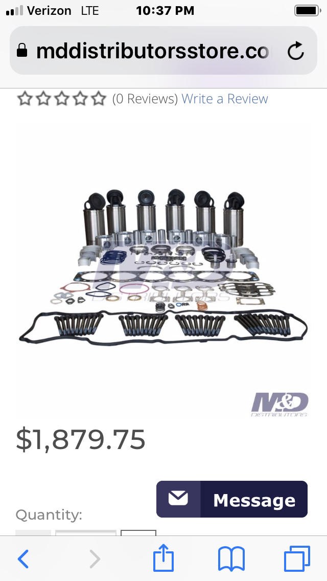

    7CD21D65-DD40-45A4-AFD8-C6477E4FE49D.png Here’s the kit I used. There’s 2 or 3 different kits, Depending on which pistons you have. But this kit is the 16.5 :1 kit. I’m pretty sure it will work in any 12.7.
