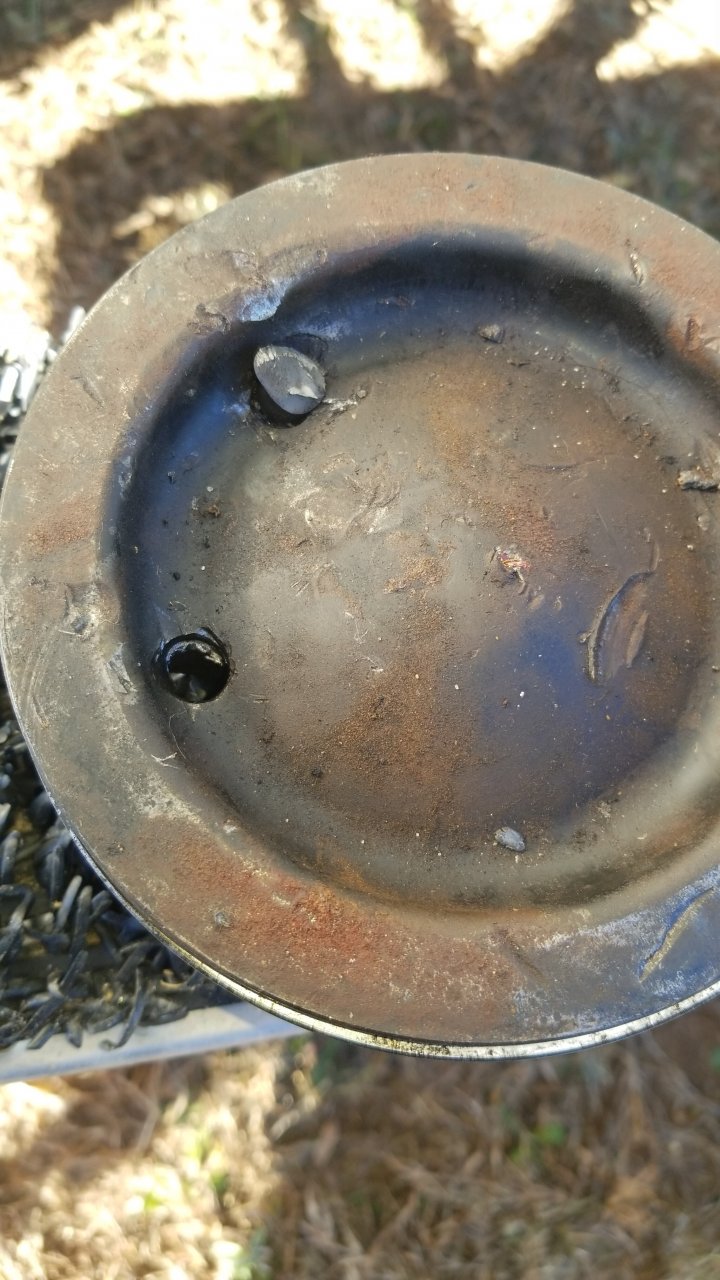

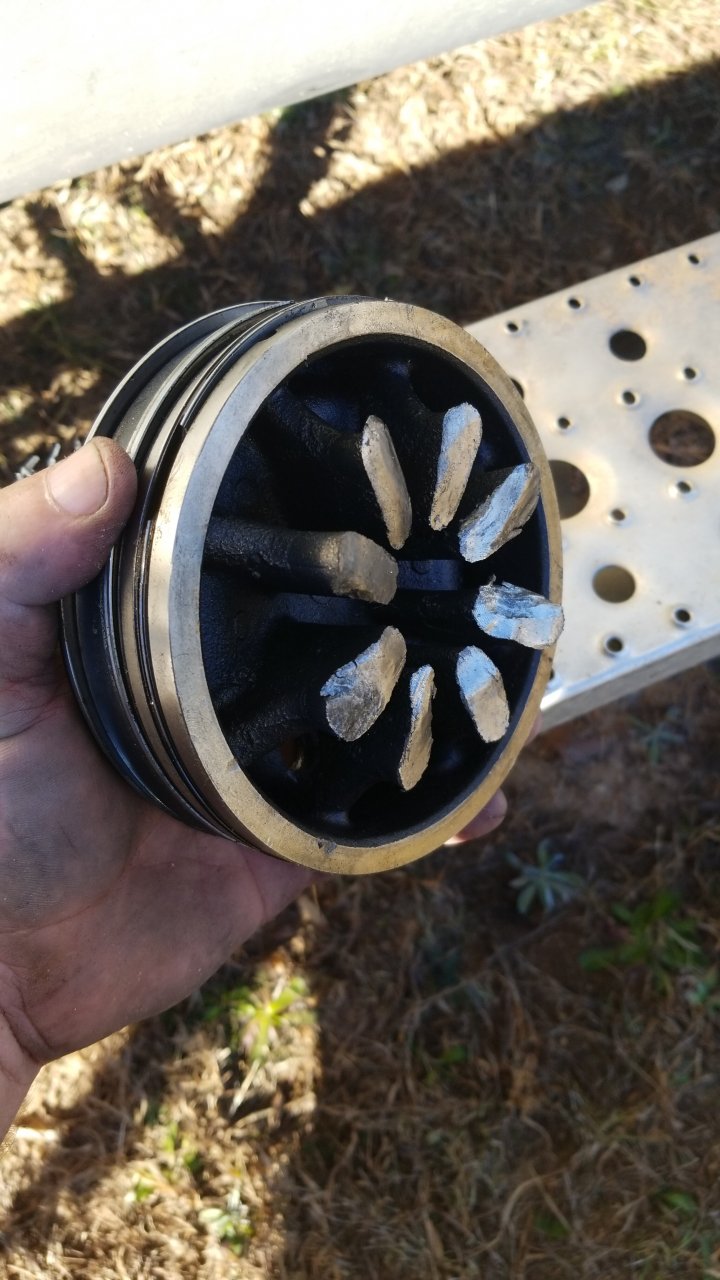

    i can tell you in a few days.... bought a columbia glider with a blown s60... 2 valves dropped and pierced thru the piston head ...290.000 miles... as soon as i get this open i will let you know.
