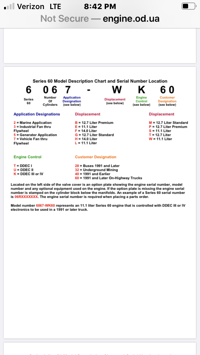

  9. Rideandrepair
    17,572
    56,926
    Aug 8, 2015
    117F0FD4-5779-41DB-9338-A52E3CDB8C48.png Sorry, I meant to post this.

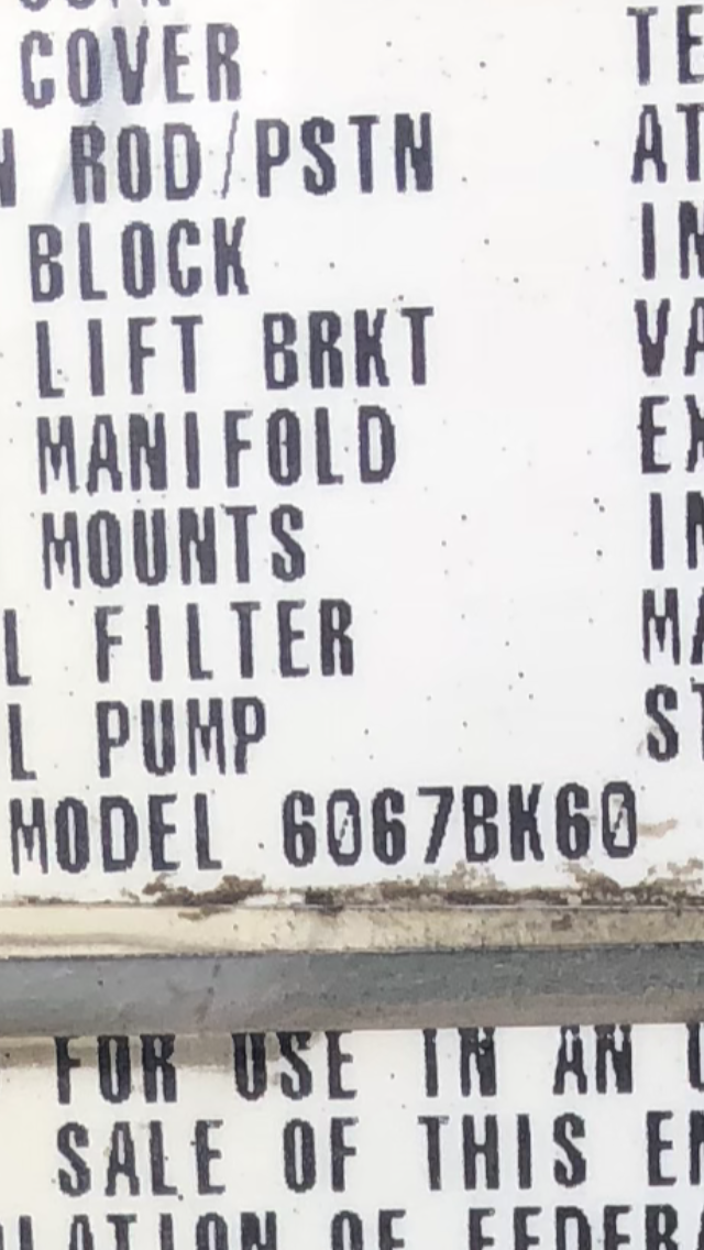

  10. Rideandrepair
    17,572
    56,926
    Aug 8, 2015
    C327E5F7-224C-48B8-92CC-AB46609B5072.png My mistake, your #s good. I have a similar # on valve cover sticker. It’s listed as a unit#. The # I was thinking of is listed as a model#.
