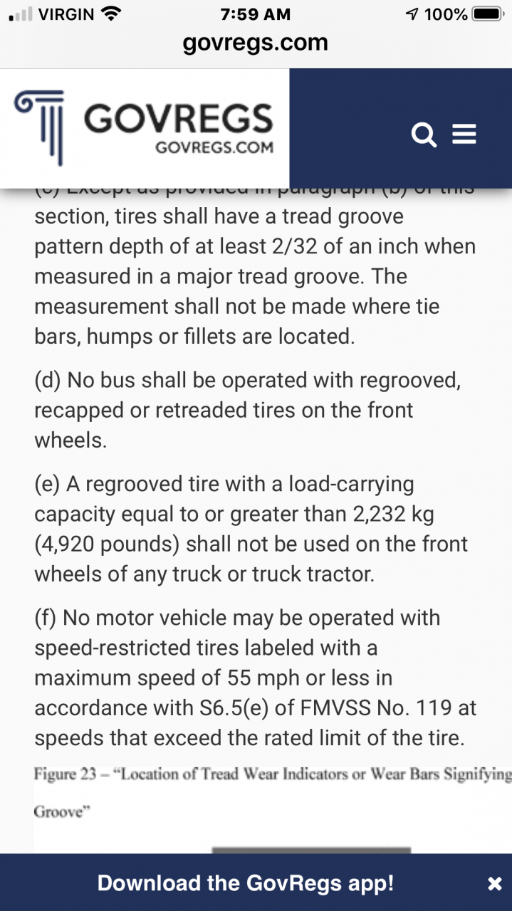

    Just my two cents, but I’ll never run recaps on my truck. Especially not on my steers. Which is totally illegal btw. 21 years and three trucks later I’ve learnt the hard way, recaps are a waste of money.

    Not illegal to use on truck steers. Thats a myth. Nhtsa 393.75 tires reg. says retreads only illegal on bus steers. Look it up. It’s in the green book that you are supposed to carry in truck with you. ( the one that the lawyers will hang you for not abiding by it) Also the tire industry has publications all over the web on this. Michelin, Bridgestone and GoodYear are the largest retreaders out there seeing how they own all the processes now and do their own. Bridgestone owns Bandag who has always been the largest retreader.

    Well I did look it up. 393.75(e) specifically states it. 32C7DF37-BD19-4231-A7C8-2E1B5300CF33.png
