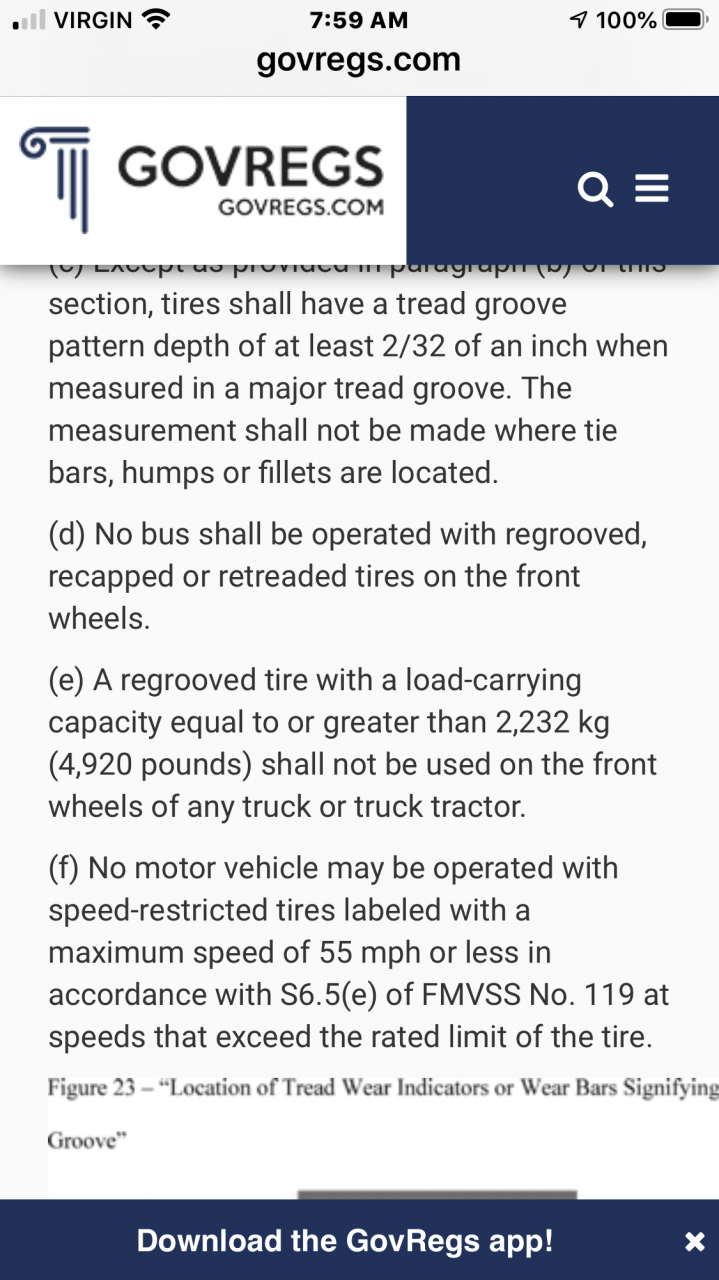

    Yep. No bus. No where does it say any other vehicle.

    Did you read section (e)? It clearly states no regroved tire over or equal to 4920lbs on the front wheels of a truck or tractor. Not sure how else to interpret that. Seems pretty clear to me.

    Re grooved is not a recap/retread.
    Regroove is when original virgin tread is cut to be deeper or resiped after it has reached wear out point to get more mileage out of it. That is a no no on steers because it does not leave enough rubber cushion between tread and casing plys.
    Totally different thing. That is what the “regroovable” stamp means molded on sidewall. The manufacturers add a little axtra thickness of rubber in the under tread ply for this feature.

    Your right! That is my main point. However, that regulation does not expressly state recaps are OK it is implied. This is another example of why these types of regulations frustrate the heck out of me. Most of the time to avoid arguments the language should be clear and not implied. To see a better example is question 3 of the regulatory guidance to part 393.75.
    Question 3: May a vehicle transport HM when equipped with retreaded tires?
    Guidance: Yes. The only Commercial Motor Carrier (CMV) that may not utilize retreaded tires is a bus, and then only on its front wheels.
    This is how the FMCSA has interpreted 393.75. It is how the states are supposed to enforce 393.75.
    This kind of crap is why there are so many debates on HOS rules. The FMCSA implies so much.
