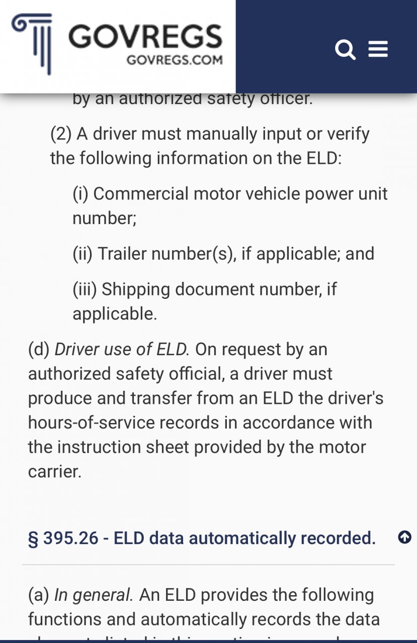

    The printout is for ELD devices that are not removable, meaning able to be handed to an inspector outside your cab. For most officers this is sufficient for their purposes, however they can require an electronic copy of the file and a compliant ELD must produce at roadside on demand by one of 4 transfer methods. Midwest Gator explains them in his post below.
    The reason for this is they use a software package to help them find violations and preserve evidence for trial should a violation be discovered and then contested.
    For those interested in the technical why and specifications, they can be found in Appendix A to Subpart B of Part 395 at this link Electronic Code of Federal Regulations (eCFR) scroll to the bottom
    The specifications for data display (which is where printout is covered) is 4.8
    The specifications and requirement for electronic data transfer at roadside is 4.9.1
    As for your specific quote, "transfer per ELD instructions" the VDO Roadlog has instructions on using the Bluetooth or USB 2.0 transfer method on their ELD compliant model 3290 with software version 12.01.00 or above. They include those instructions in their listing on the ELD self-certification website here
    ELD - Registered ELDs just enter VDO in the search bar to see their only device on the list.
