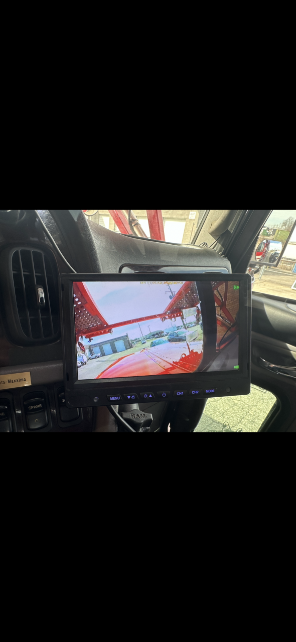

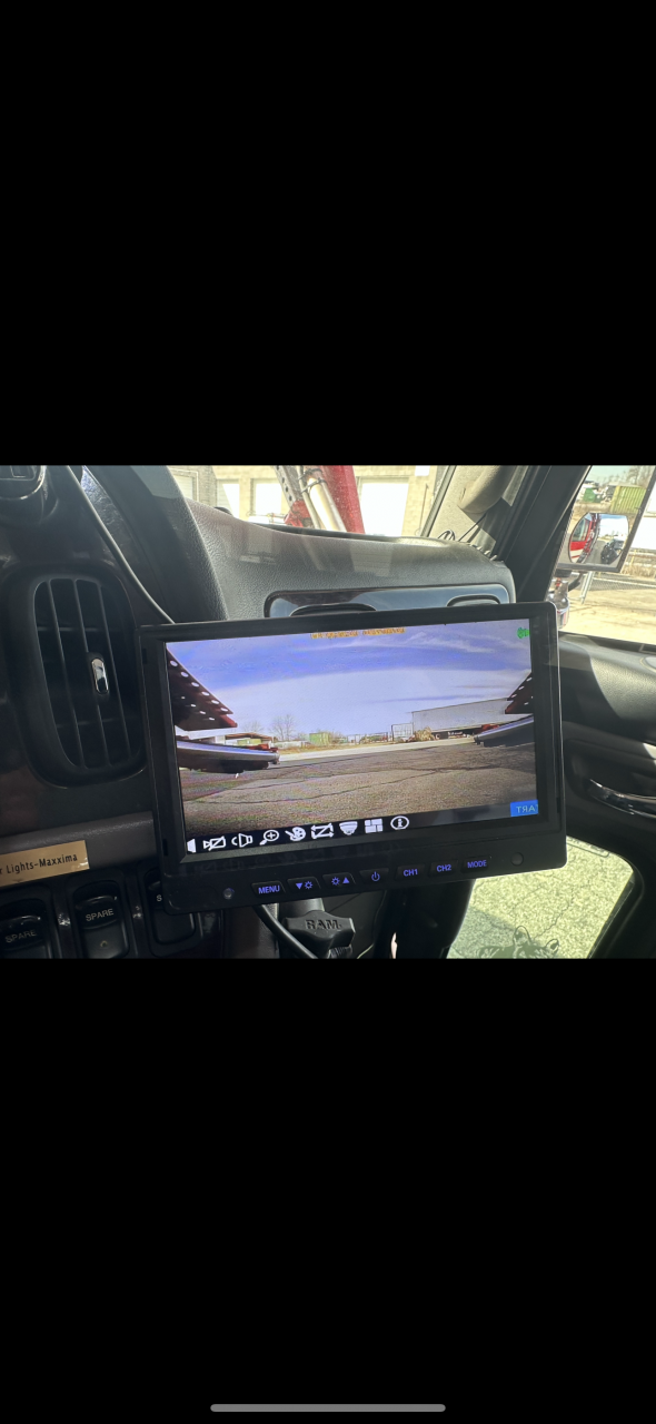

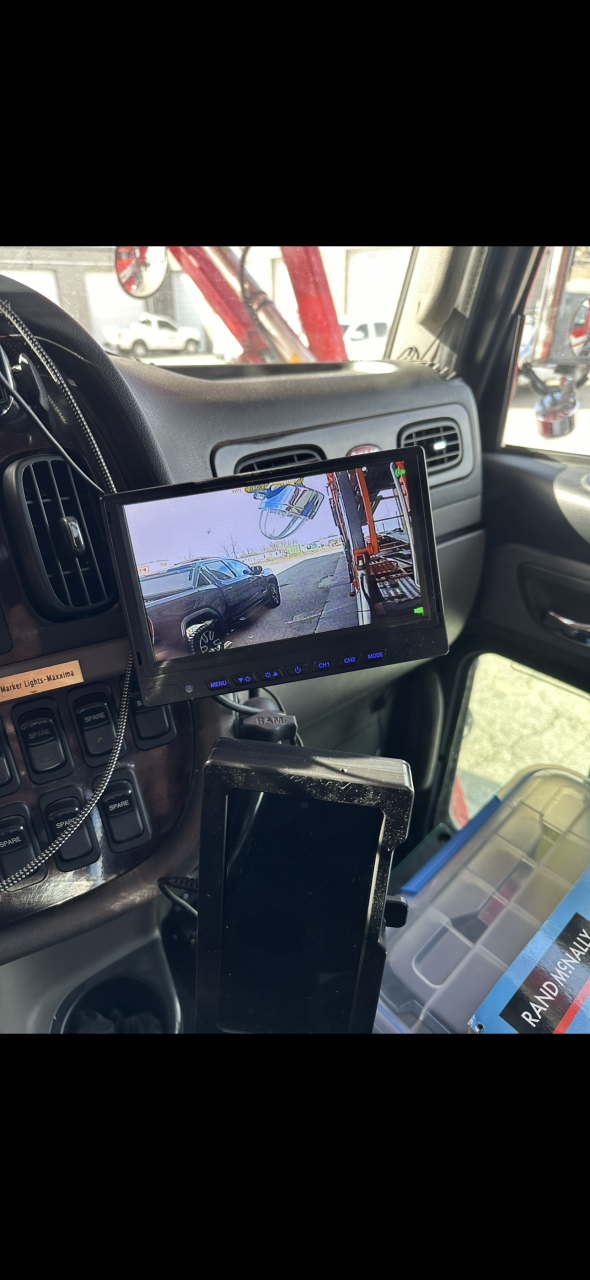

    I use the Falcon Electronics 3-8 camera system. If you use the same trailer all the time it is well worth having a camera on the rear. IMG_2621.png IMG_2620.png IMG_2619.png

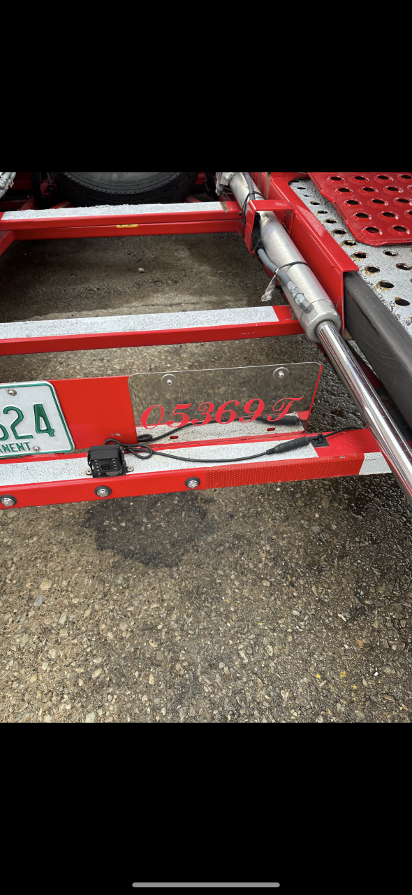

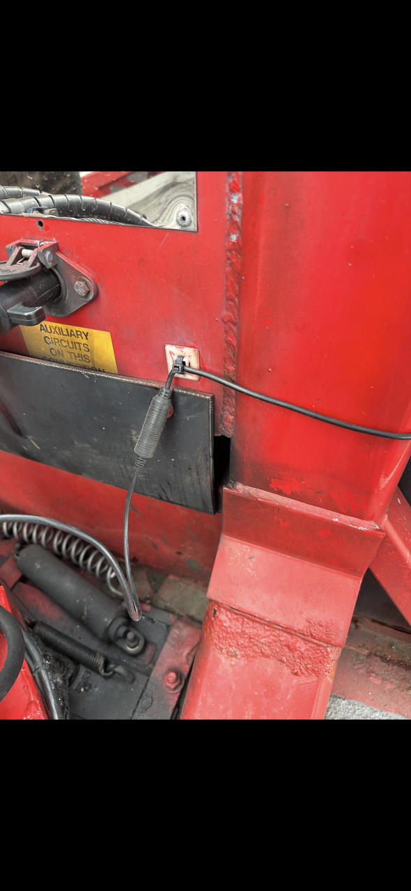

    I got the largest hard driver memory and it does rewrite when it is full. I run mine 24/7 and I don’t know exactly how many days before it re-writes but it is several. They make a plug very similar to the plug on the front of your trailer, but you don’t need one because each cable has a male and female end. Therefore you get one the length from your DVR to the back of the cab. Then I have one from the front of the trailer to the camera on the back of the trailer. The cables plug in to each other and only will connect one way. Any outside connections need a rubber sleeve or heat shrink. I believe all the cables now come with a the rubber sleeve to cover the connections which I have on the tractor to trailer connection. Even though the connections are weather proof without the heat shrink or rubber sleeve it will eventually get moisture. If you catch the moisture early when you notice one camera getting fuzzy and use electrical contact cleaner when you find it you will save the plug. A battery drill, zip ties and either rubber grommets or silicone is about all you need to install it in a couple hours.
    Back of trailer camera mount and back of tractor are the pictures. It’s a car carrier so it may not be familiar looking to you. IMG_2623.png IMG_2622.png
