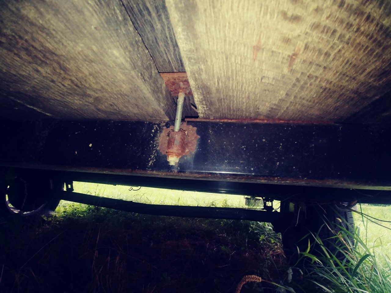

    This sounds interesting but I can't quite visualize it..If it wouldn't be too much trouble sometime when you're by your trailer, would you mind snapping a couple pics and posting them here?
    The front has a regular bulkhead to stop the wood from moving forward and has a quarter inch strap over it.
    The backend I used angle with pieces of round cut to hold the boards down.
    If you zoom in on the picture in the garage you can see that I used pieces of round and a bolt to pull it tight left to right.
    In three spots across I welded a stud to the quarter inch flat and and put it through a piece of round welded to the crossmember.
