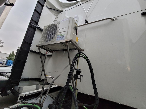

    Mini split is a Pioneer 120V 9000btu heat pump. The one to get is their 22 SEER ultra high efficiency model. That's what's on my son's truck. When I ordered mine, they shipped a 20.5 SEER high efficiency (lesser model) by mistake and I didn't realize it until I was halfway through the install. Honestly the specs were the same in terms of battery consumption in cooling mode, with about 15% less maximum airflow. So I elected to take a credit for the lesser one and just finish it. It has not been a problem, and the unit cools beyond expectations. The main benefits to the higher efficiency unit is lower consumption in heat mode, and slightly more airflow as I mentioned.

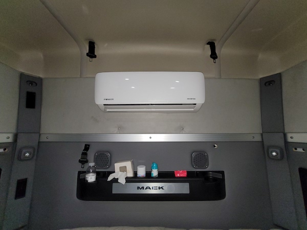

    The outside mount I built out of 304 stainless. Legs attach under the cab at the bottom, flanges to the back of the cab up top. It's seriously over-built, so I expect the unit to dissolve into rust long before the bracket it sits on suffers any harm. Inside, I took out the top bunk since I don't use it. It's kind of big, so if you needed that bunk for storage, it could still work but would limit air circulation of course. I attached it to the back wall on the factory nuts that would normally have a cabinet mounted to them in a solo cab. There's a piece of 1/4" plywood attached to the wall, under the upholstery. The bracket the evap/fan mounts to is then screwed to that securely.
    Here's the inside and outside units.
    ETA: this is actually the one on my son's truck. Same style install. The only way I could tell is the assortment of crap in the tray below the inside unit LOL. Both trucks are installed the same. The 20.5 SEER compressor unit is smaller on mine, so I had to improvise some 1-1/2 flat steel supports in the middle to mount it solid. I built my frame to the same dimensions I used on the first one. My first clue I had the wrong unit? When the compressor darn near fell through the hole in the middle when I went to set it up there.
