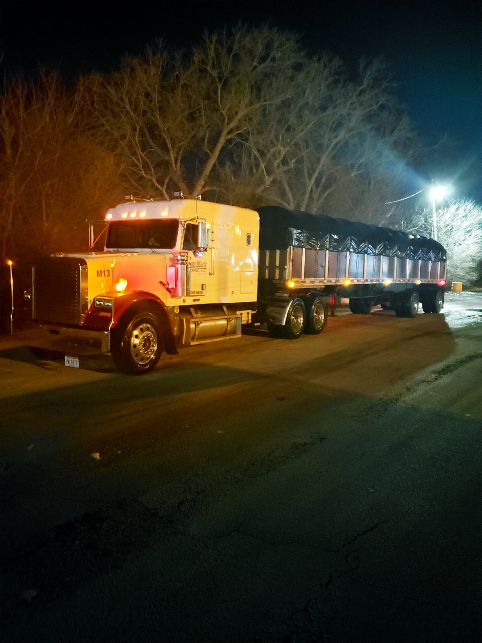

    29,900 steel aluminum combo.

  7. jamespmack
    26,400 with my hopper too.
