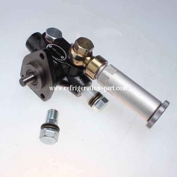

    And check to make sure the primer pump actuator is closed good (screwed down tight) and you don’t see any fuel leaks up in the engine compartment (even seemingly minor ones)
    It should look similar to this
    x1Heavy Thanks this.
