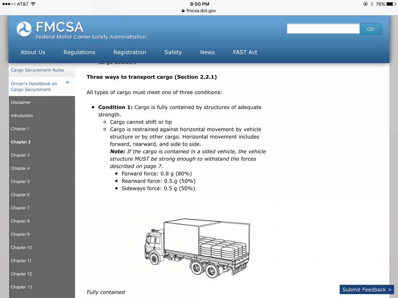

    I really like that you post regulations for how to secure cargo in a van vs. A flatbed. I posted the regulations concerning loading a flatbed which clearly state the product must be touching or have vertical bracing to keep the product from moving in towards the center. Yes a proper bulkhead should restrain any forward movement but does not solve the issue of the product having space in between to migrate to which would loosen the straps. I highly suggest you reread the securement manual and your green book.

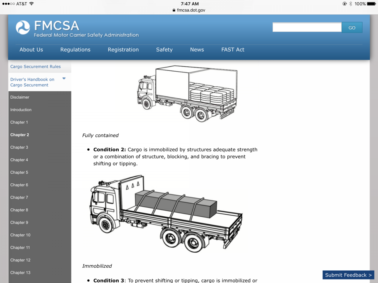

    Sorry the picture of the van confused you. Here is more of the page
    It's not a just a van regulation!

    And here is the relevant regulation which you chose to ignore. I suggest you go do some more reading. You simply cannot have items unrestrained between 2 bulkheads. If the outer bundles move then the straps loosen. I don't care how much you think they won't move you have to treat it like they will. If you simply can't grasp this concept I suggest you go back to dragging a van and quit giving bad advice. With that I'm done speaking to you. The good help I get from the professionals on here is more important then going back and forth with you.
