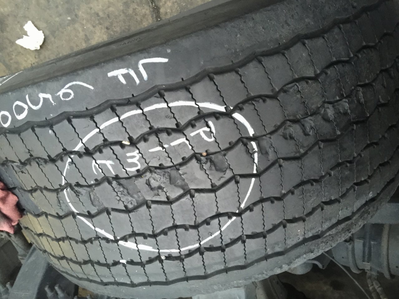

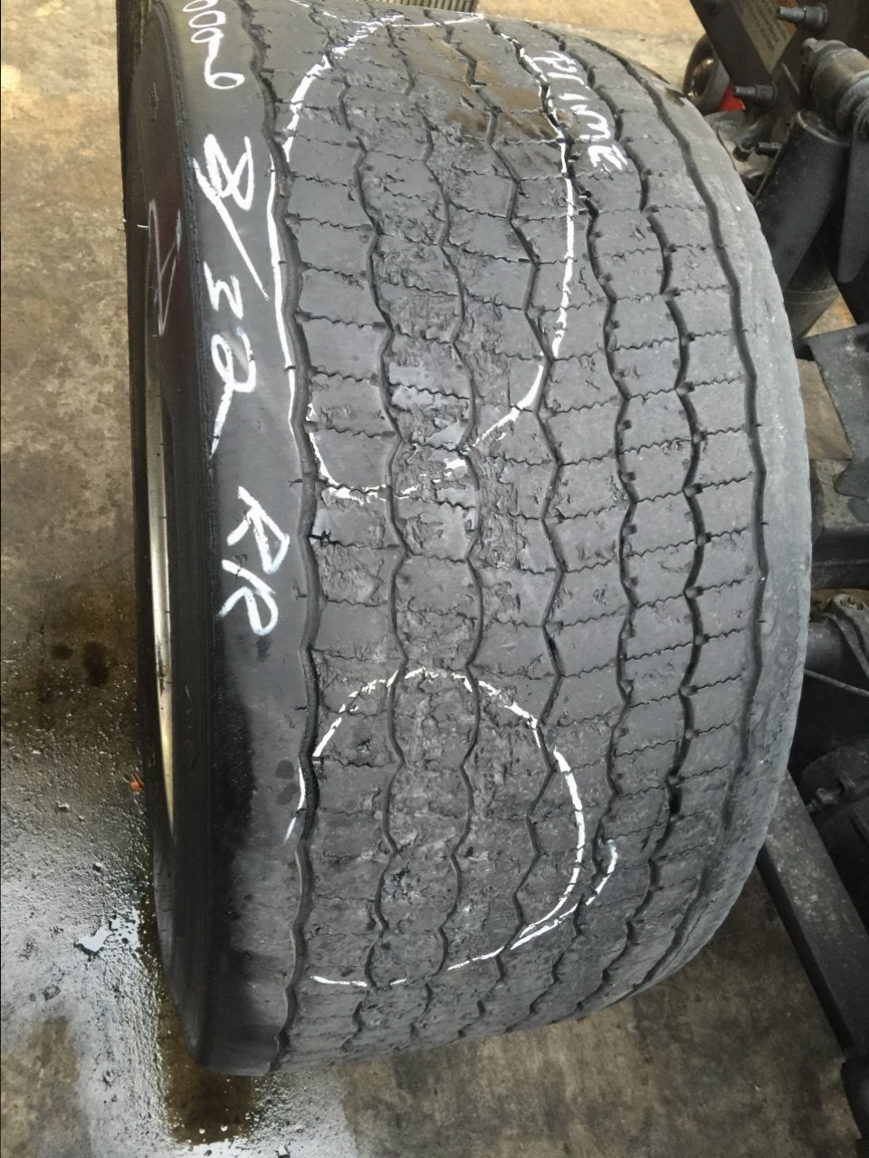

  8. Tmichael2332
    Tmichael2332 Light Load Member
    67
    32
    Jan 9, 2014
    Those tread depths were what TA measured and wrote on the tires. Prime wanted pics. According to the guy I spoke with they're not approving any tires unless it's at a terminal.
  9. icsheeple
    icsheeple Trailing the Herd
    2,548
    2,552
    Nov 1, 2013
    Kansas City, KS
    I looked it up:
    (b) Any tire on the front wheels of a bus, truck, or truck tractor shall have a tread groove pattern depth of at least4/32of an inch when measured at any point on a major tread groove. The measurements shall not be made where tie bars, humps, or fillets are located.
    (c) Except as provided in paragraph (b) of this section, tires shall have a tread groove pattern depth of at least 2/32of an inch when measured in a major tread groove. The measurement shall not be made where tie bars, humps or fillets are located.
    I don't know what they are talking about when they mention tie bars, humps or fillets.

  11. Tmichael2332
    67
    32
    Jan 9, 2014
    Here are some pics yall tell me what yall think. These are just a few I snapped of the "good" side up.
