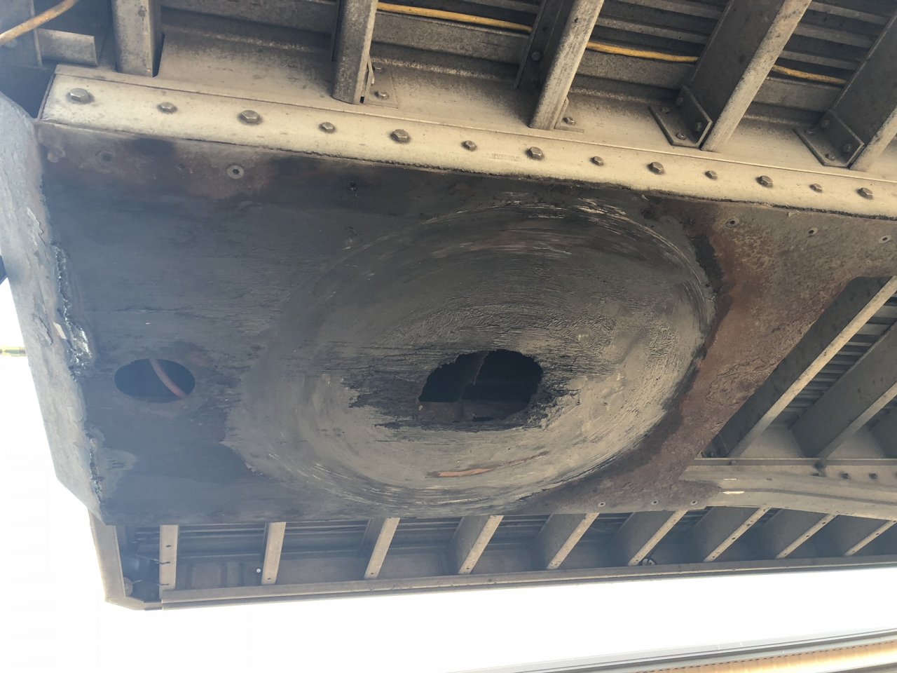

    I don't know what year they changed, but it was a lot later than 2000, the steel suspension and kingpin plate are bolted to the frame without any isolation. I recently spent $3,000 to fix the kingpin plate fixed.

    So I'll be looking for rust jacking where the frame sits in the straddle mounts of the suspension. I guess that's the same issue with the upper coupler?

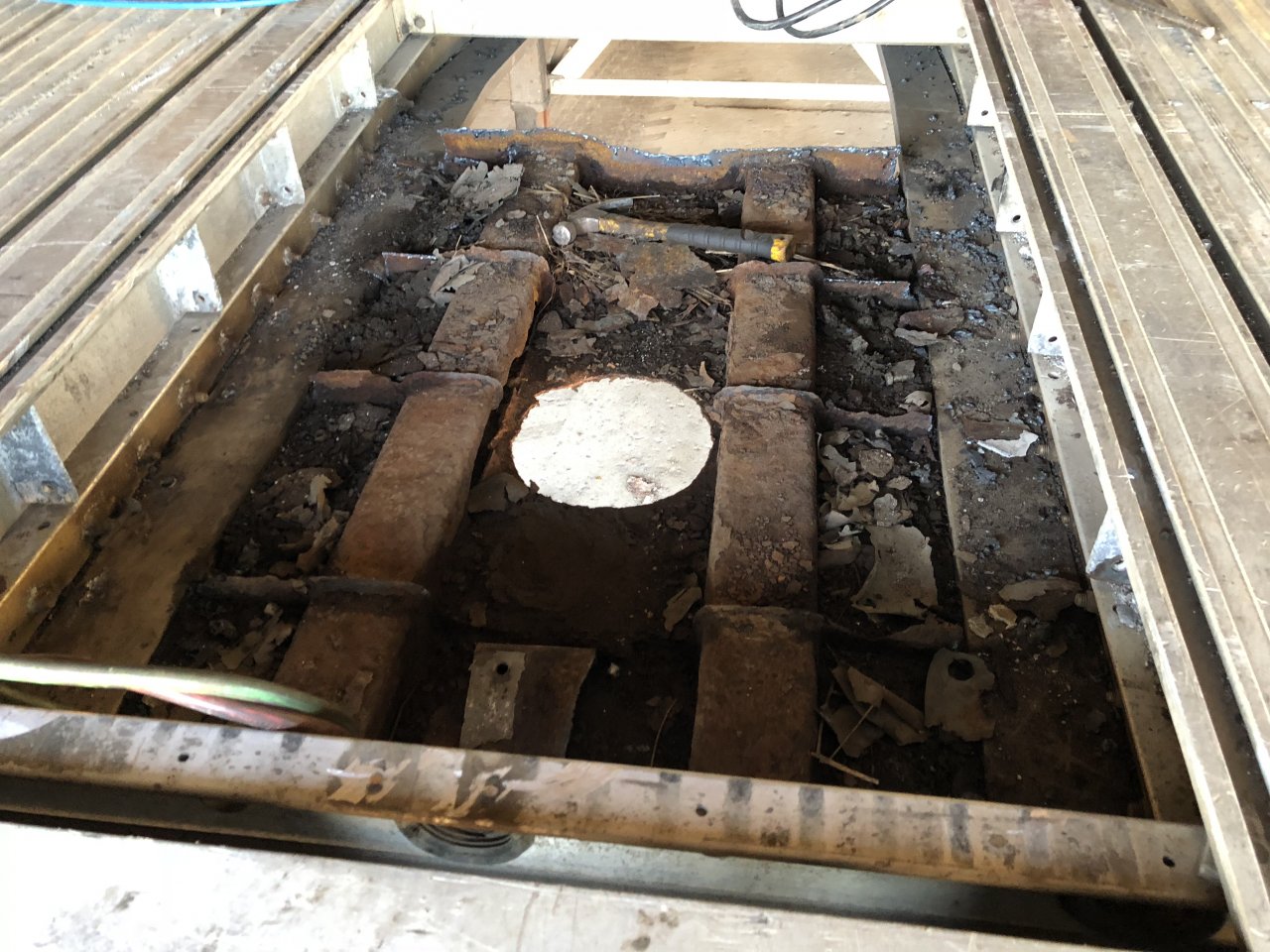

    The biggest problem with them is where the suspension hangers meet the frame. 467677BF-B6BF-4519-8B8C-CEB663459237.jpeg E132C774-CAAB-4B85-AF1B-A60F1611B2FC.jpeg Check the 5th wheel plate carefully. This is what they look like in the inside.
    My new trailer has a aluminum 5th wheel plate now.

  11. Tug Toy
    Tug Toy Road Train Member
    7,150
    74,883
    Jul 4, 2015
    Corn field
    They still suck. I’m ok with everything about them except them #### suspension hangers. They are the only ones doing it that way despite themselves.
