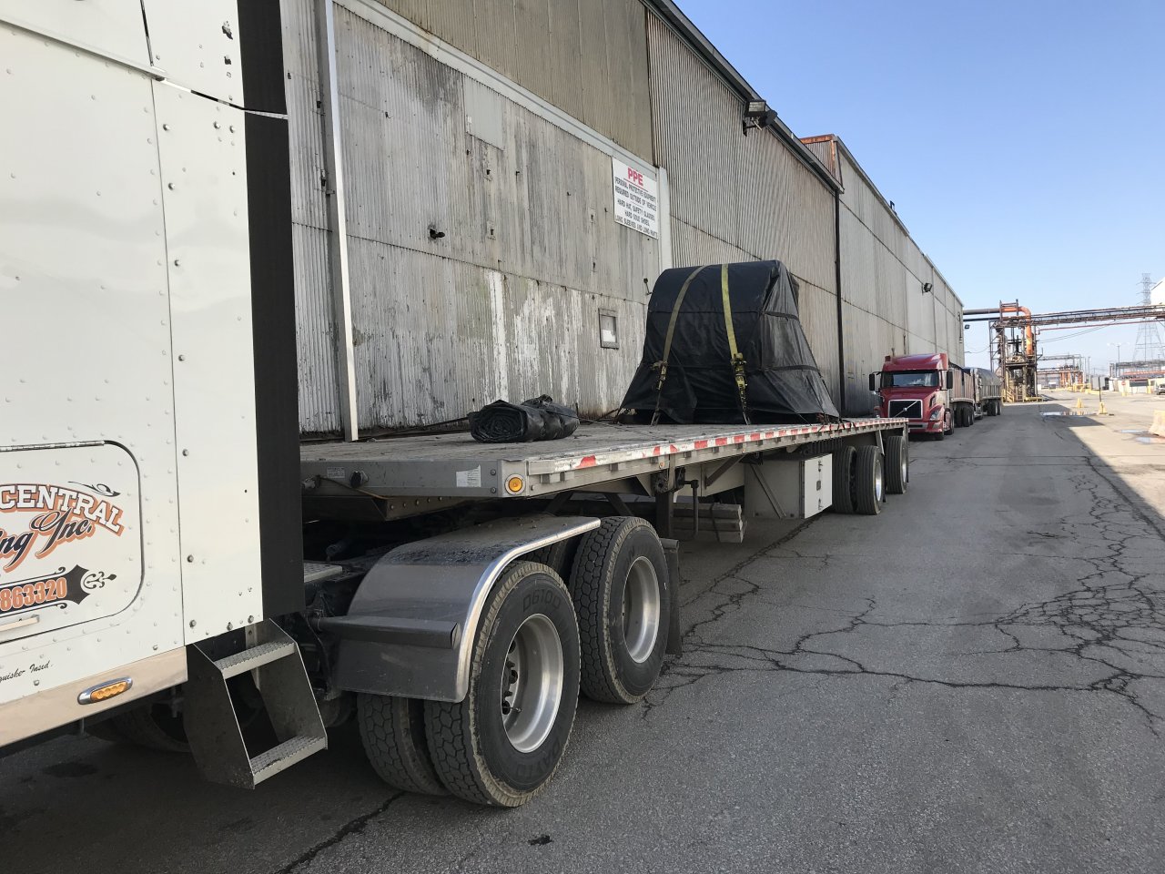

    I didn't need to use them on this load but did anyhow. Just an example for you 2 see how they can be used.

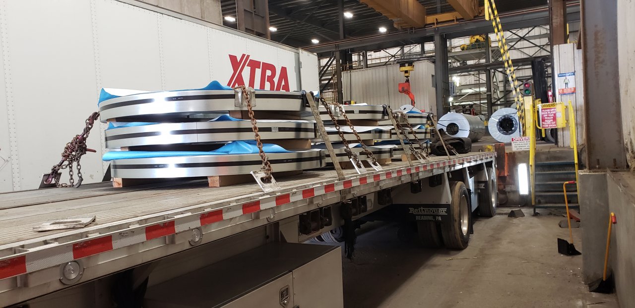

    Last reitnour i owned had a conestoga kit and i was doing ltl with it. Made for some significantly easier tying down on machinery vs trying to chain down thru the rubber gasket on the pipe spools from the ground/then running the chain where it needed to go/back on the ground to run the other side around the spool/back on the deck to tighten all the binders.
