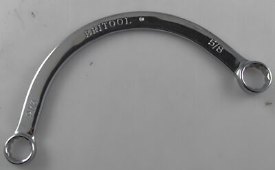

    You'll need a Spanner (wrench to you) something like this for the rear Stud.. I made one up by heating & bending a normal type Spanner..
    DUNE-T, bzinger, tommymonza and 3 others Thank this.

  8. Diesel Dave
    9,931
    34,878
    Jan 20, 2010
    Hesperia, Ca.
    I made my own. Got the torch and bended it. Still have it somewhere in my toolbox.
    haycarter Thanks this.

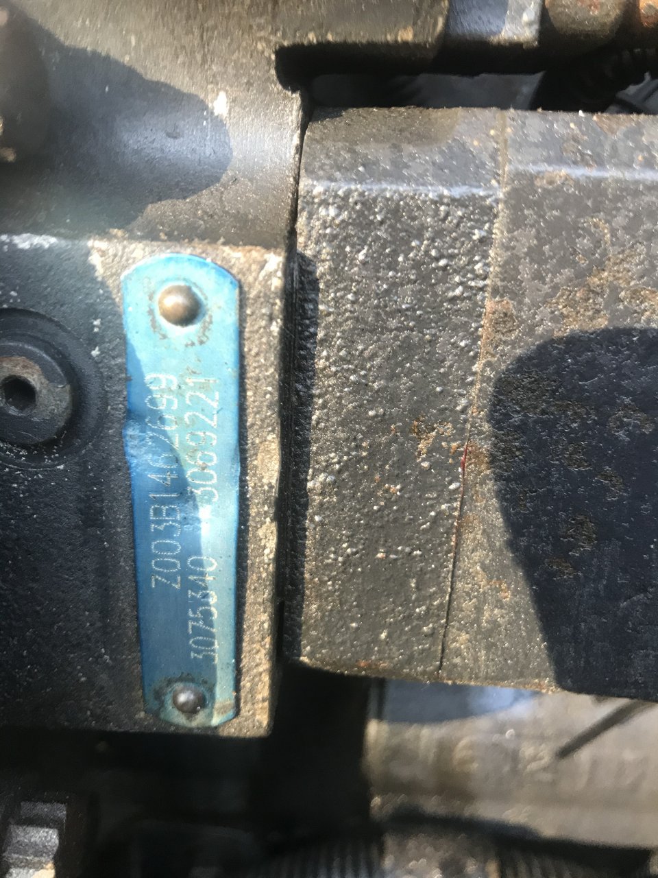

    Does Cummins offer a gasket/O-ring kit, for the pump? If so what’s the part number? And also, my pump doesn’t have the fuel filter attached.
  10. Fieldrat
    Fieldrat Bobtail Member
    43
    67
    Jan 31, 2021
    Whats your esn?
  11. mile marker 27
    mile marker 27 Road Train Member
    1,419
    1,739
    Dec 4, 2019
    06AC4700-64F7-4EA4-99EA-3A925F983EC8.jpeg I’m not around the truck at the moment to get an ESN but this tag is on the pump.
