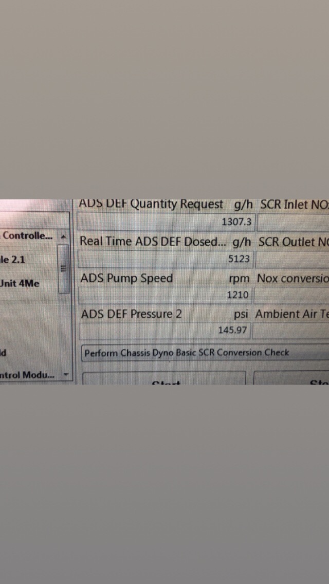

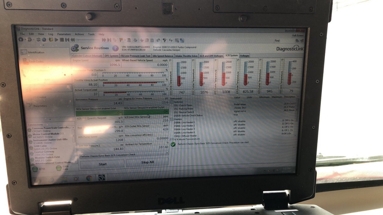

  6. Aleks_Andar
    Aleks_Andar Bobtail Member
    29
    Sep 11, 2015
    Guys please help.. Higher PPM on outlet than inlet

  8. Aleks_Andar
    29
    Sep 11, 2015
    I did def quantity test ..120ml

  11. Aleks_Andar
    29
    Sep 11, 2015
    Dosing wayy more DEF then requested ?
