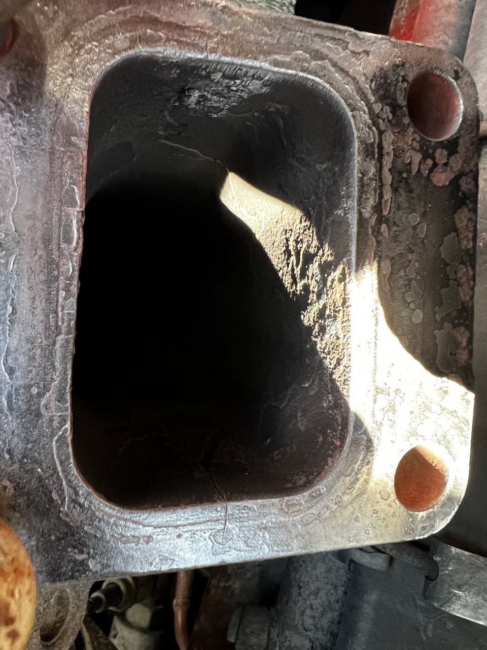

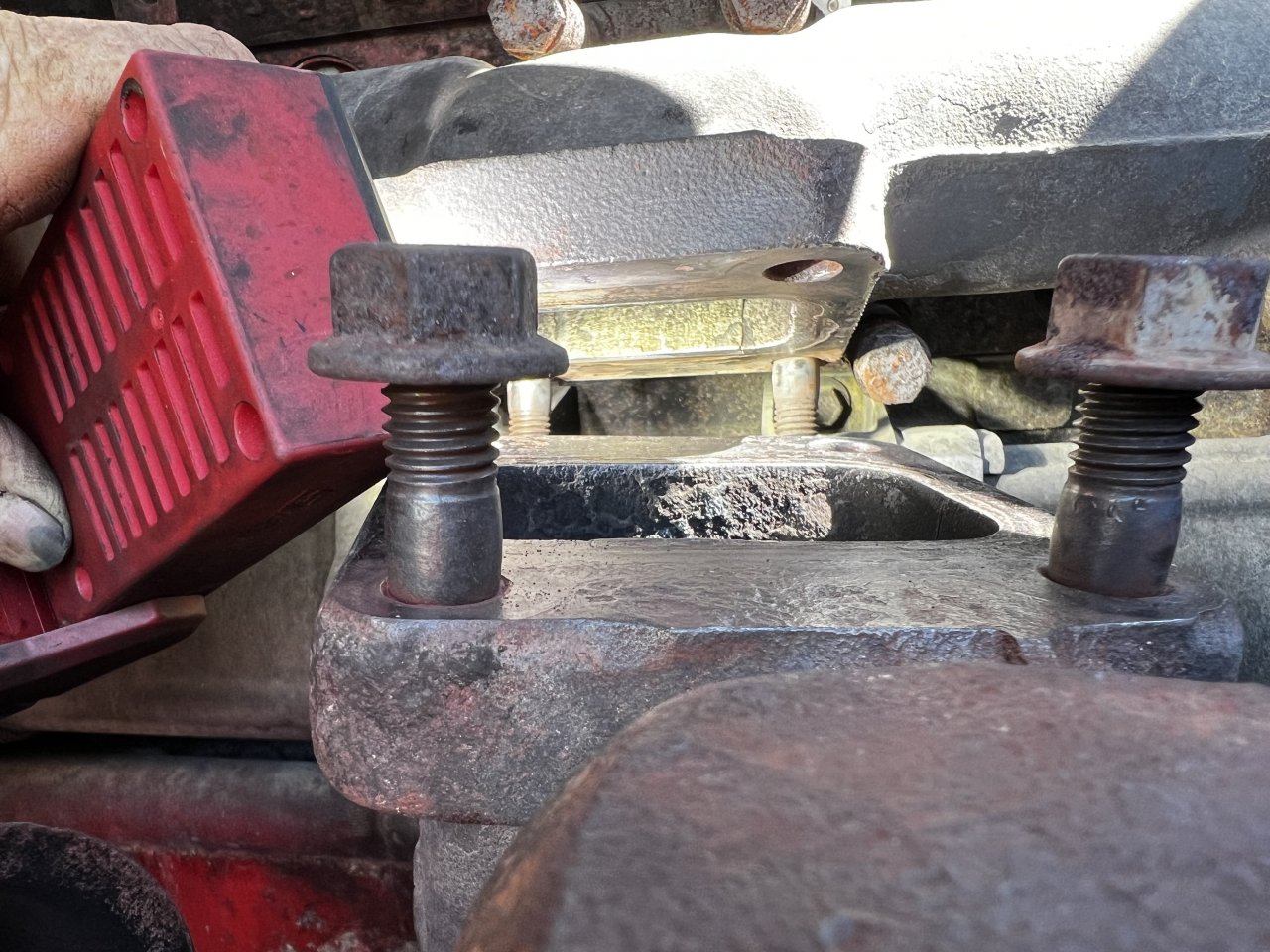

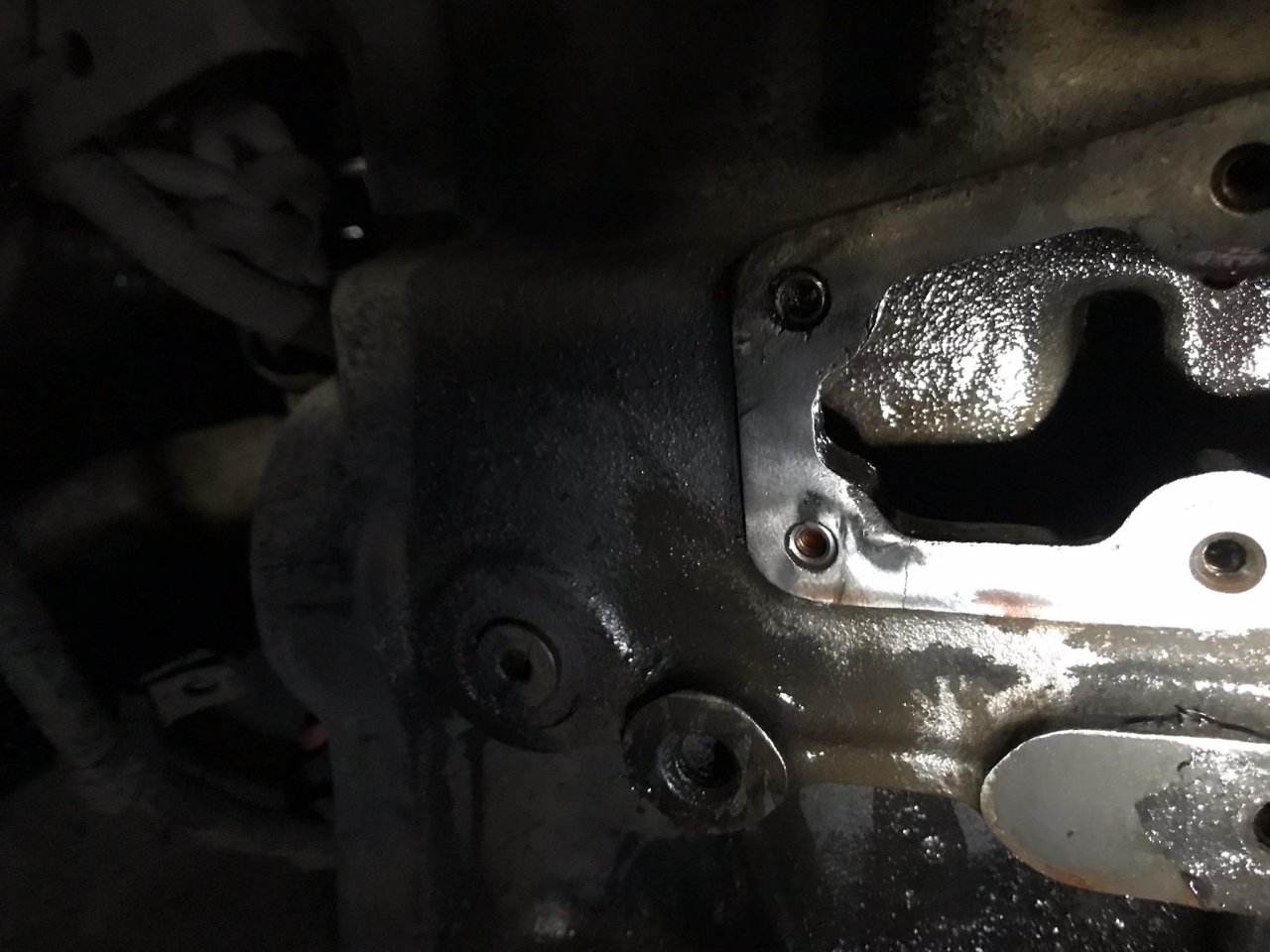

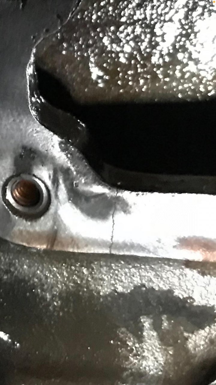

  5. Neverquittrucking228
    Neverquittrucking228 Light Load Member
    108
    52
    Feb 23, 2021
    Mechanic left a bolt lose on my turbo exhaust which came lose & caused a hairline crack
    Rideandrepair Thanks this.
  6. Neverquittrucking228
    108
    52
    Feb 23, 2021
    Not sure I’m not a mechanic by far
  7. Neverquittrucking228
    108
    52
    Feb 23, 2021
    Here’s the photos of the cracks. Let me know what y’all think

    Have heard the term, but dont know much about it. From what I have heard it would probably be ok for something that doesnt have sudden and/or extreme temperature shifts.

    You're wasting your time and money welding that. It's junk and belongs in the scrap pile. A good aftermarket manifold costs about $1,750+/- if you've been running since posting this where's your cash going? You could have bought and paid to have 2 or 3 of them put on by now. Even an OEM one if cheaper is not a bad option. Probably a better option for you.

    Is your ISX a model with a variable geometry turbo? If so I would replace the manifold, the replacement turbos are ridiculously expensive.
