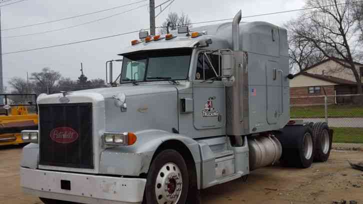

    I am in the process of doing this -- but without the plastic sheets & sheet metal screws...
    I bought the United Pacific 35775 & 35776 LED 379 headlights from TruckID for $403 each. Instead of just screwing plastic over the old headlights, I did the body work to fiberglass & paint the old headlight holes (I completely removed the old fiberglass buckets). It looks really nice.
    I did learn that, because Peterbilt narrowed the front grille to make room for the fender headlights, you now have to have spacers made to make up for the increased angle of the sides of the hood/ grille. Mine are being made up at a local machine shop right now; once they're done, I can mount my new lights. Without the spacers, the lights tilt forward 5 degrees (like the ones in the picture, above).
    Here is a picture of my 377 so far -- headlights should be on by tomorrow night.

    The United Pacific 35775 & 35776 LED 379 headlights from TruckID for $403 each, and spacers your local machine shop can make for under $250. Here is a drawing of the ones I am having made right now.
    You can either screw plastic over the old headlights, or you can do like I did & fiberglass/ paint them so it looks like factory.
