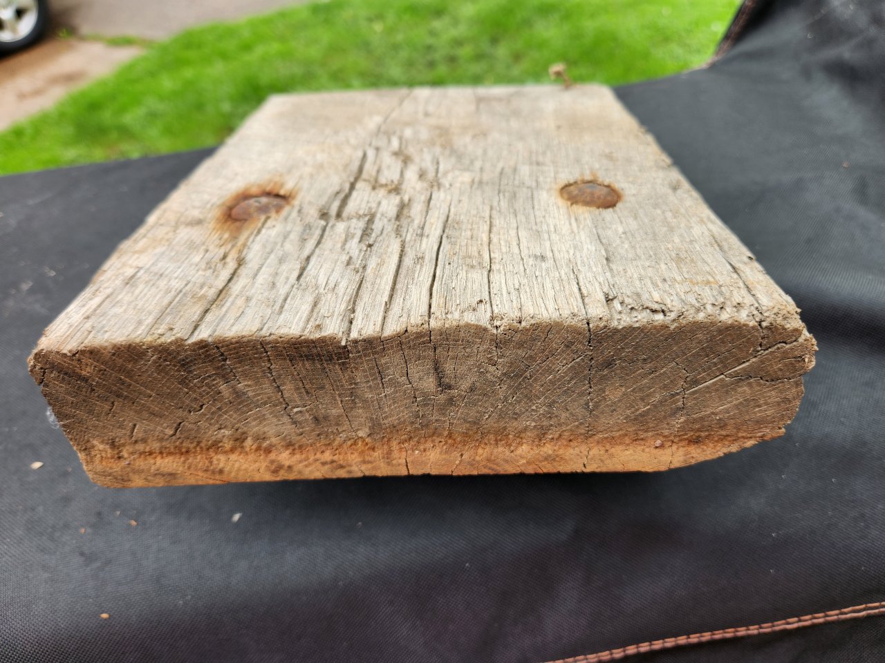

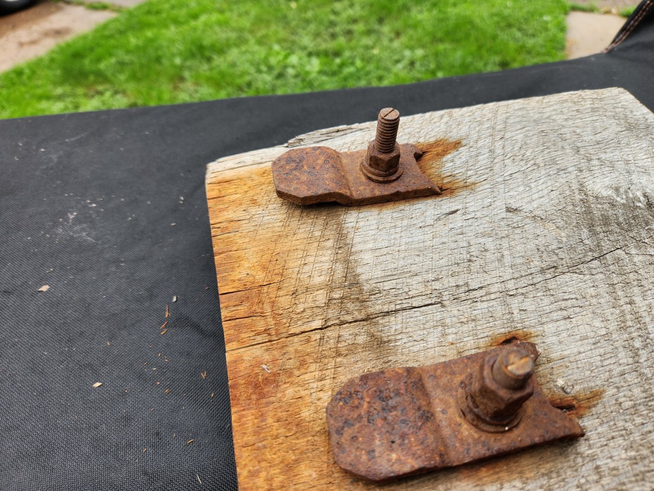

    The clips are the way to go. Only drilling the wood and not the cross members is a game changer.
    And the wood and clips will have a little give when the trailer is flexing.
    Doing it this way yourself, will change your life.
    And if you break a board, very easy to replace.

    Totally. I will never use screws again
