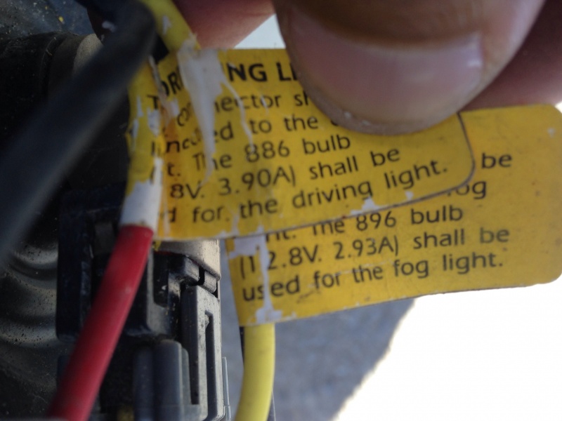

    Guys can you tell me about bulbs, i find that fog light is size 896 and 886 from volvo dealer,when i shopping for a bulb to replace i end up finding only 881 and i been told that 881 size fit 886 896 and more... Is that true? If i put this 881 will i get message on my computer?
  8. NukeE
    NukeE Bobtail Member
    2
    Sep 15, 2014
    You shouldn't get a warning message with that bulb, but it's lower wattage:
    881 27W
    896 37.5W
    886 50W
