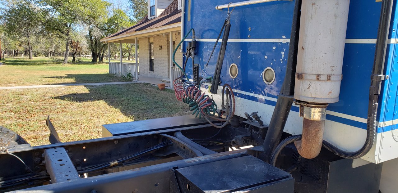

    Set up my catwalk and pogo stick.
    Before:
    After:

    I mounted that box in the little picture. Couldn't pass it up. Marked down to $400. Made of 1/8 steel, greaseable hinges, and very nice. New cab air bags and governor as well. I also set up a dump valve for the rear axle on my spread that I can control with the trailer aux switch on my dash.
