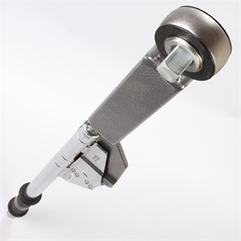

    I'll continue talking to myself when I get the wrench, thanks.
    Looks kinda like a microphone...

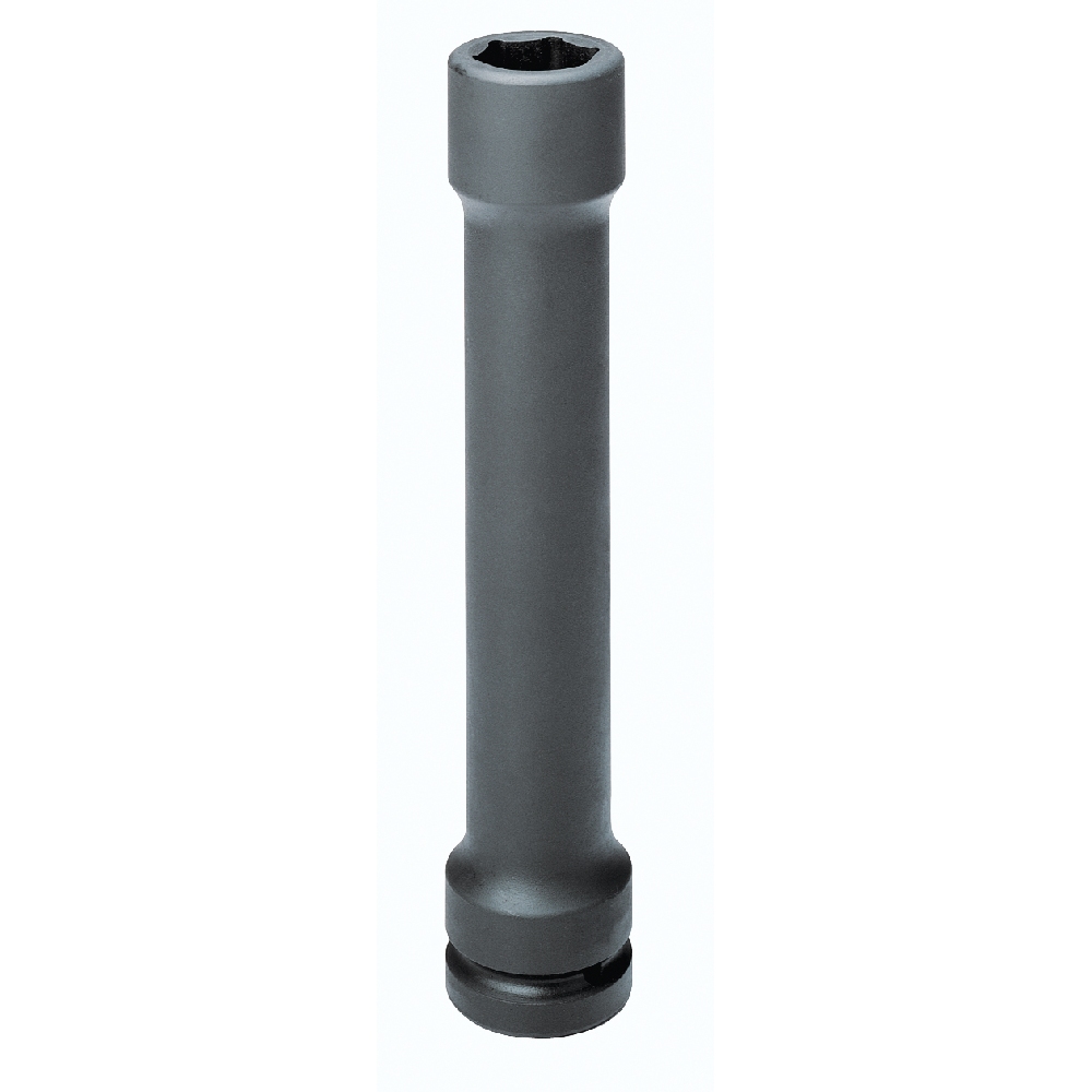

    I also ordered an extended depth socket, it's 5 lbs and 10.5 inches long with a stud sized hollow shaft running its length. Whether or not I need one deeper than the 3.5 inch long socket for bolt clearance, I think it may be advantageous to use in general, as it is bigger around than an extension to hold while positioning, and the short extension I add to its end for extra torque wrench clearance would not detach as a result, because I'll be holding the actual socket to move it around.
    Could also use it to thump tires. :)
