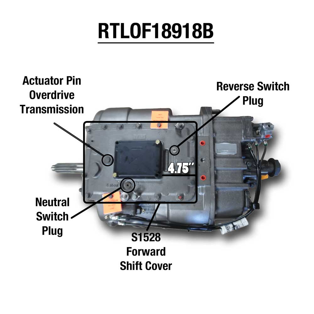

    Not same transmission, but plug would be in same area.
    Heavyd, magoo68 and rank Thank this.

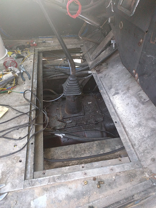

    Plug is easy to access if you can remove the trans access cover. Mine is off as I am finishing rewiring in that area. And, yes, I am installing a reverse light. Here are some pics...
    access cover removed...
    reverse switch
    The plug is the slotted one just to the right and back of the shifter. The switch has a ball that gets bumped by a reverse shift linkage just under the plug.

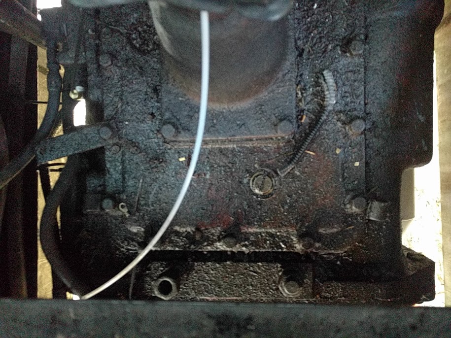

    It should be right about there, just behind where the shift tower bolts on to the top cover. DD49AF0D-C5A4-48D1-A3DB-987A7A42B047.jpg
    rank Thanks this.
