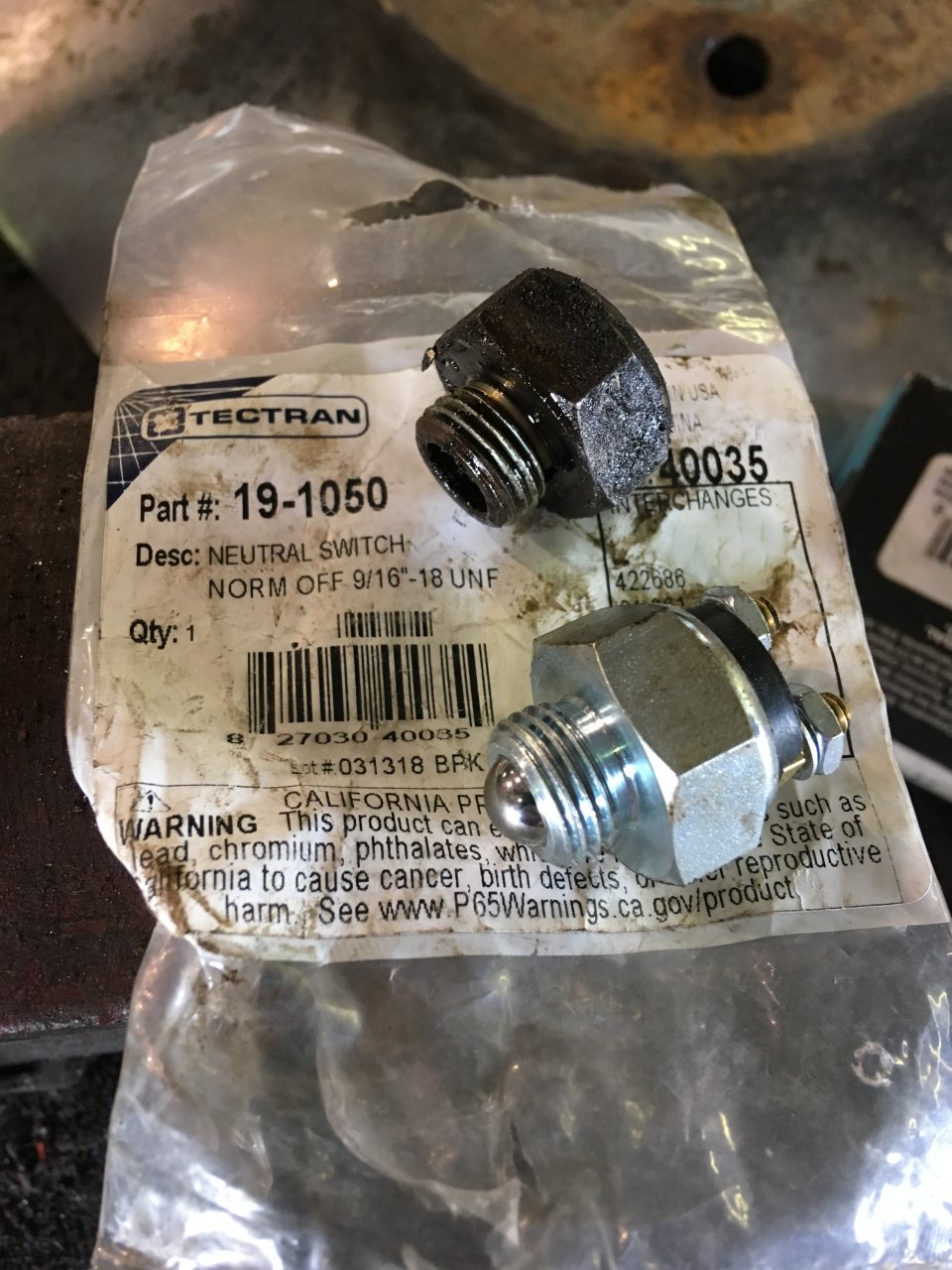

    607F70A7-FAB2-4E13-8686-6C07F69578A1.jpeg 03692D06-2268-4B16-8BEA-EAA1B65EBA8E.jpeg Turns out there was a switch in my trans. It just looks a little different than I thought it would more like a vent lol
    @wore out @GrapeApe

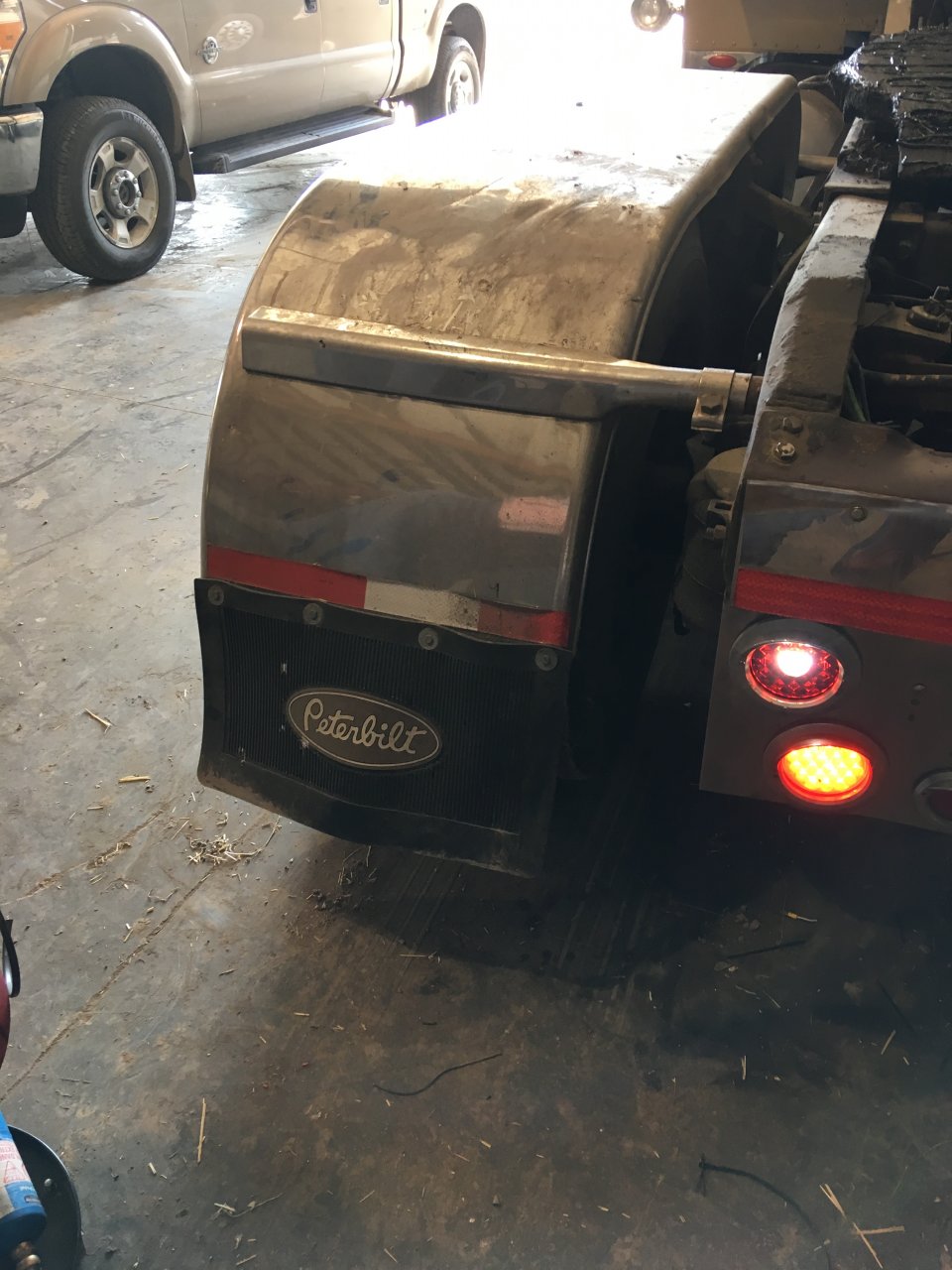

    Reverse lamp installed. Found a All in one LED as suggested by @GrapeApe and @Luwi67. got the transmission switch suggested by @Hogleg from the local truck parts store and wired it From a keyed breaker on the panel like he said. Thanks to all that replied and sleep well tonight knowing that the world is a safer place now that I’m compliant with 393.1. Thank you too Officer Spak*
