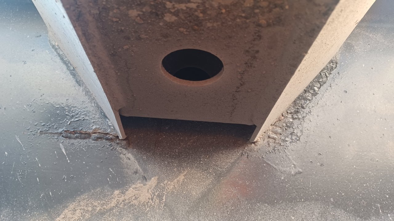

    A question, especially to owners, is there any specific maintenance that needs to be or can be done to prolong the life of the decking boards on Lowboy and flatbeds? Our 2020 lowboy's decking boards are dry, brittle and are splitting and cracking. We even had a failure in 2 boards so we are considering re-decking the trailer. Afterwards is there any recommendations? Also we have a crack developing where the crossmembers between the tridems meet the frame. Can that be welded by any shop and still fly with DOT?

    That weld looks like someone already tried before. It is not a good weld. You need to take it to a qualified welder. That is a stress point if not done right it is going to crack again. Quality hard wood for the decking all wood is not the same. It's the nature of the business of hauling heavy. It just has to be replaced over time.

    It was prior to my companies purchase of the trailer 8 months ago. Any idea of ideal/average decking lifespan?
