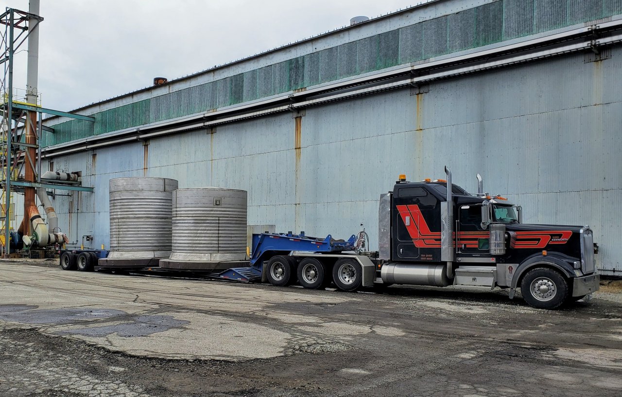

    Here I am with our Nelson Mini Deck. Deck height is nice at 9 inches. But that camber won't come out until you get capacity like Old Man said. Both of these coil covers only weighed 15k together. Overall height was 15'4". 20210223_120301.jpg

    I can get my new trailer down to 9” with 15 k on it, 34’ well
