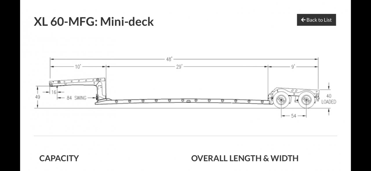

    Are you sure that XL is 53’ with only a 29’ well? Our two axle 35 ton XL’s are 48’ with 29 in the well.

    It actually has only a 28’ well.

    This is the drawing xl has for their 30 ton mini deck. Do you mean 53’ with the flip? 092A89EB-1B0A-40B7-A722-59D937148ADE.png

    yes its 53 with the flip. Theres something about the way its built up front where you don't get the full deck space. The Siebert has 33 in the well and they call it a 53ft w/out the flip.

    Now we are talking!
    that makes more sense.

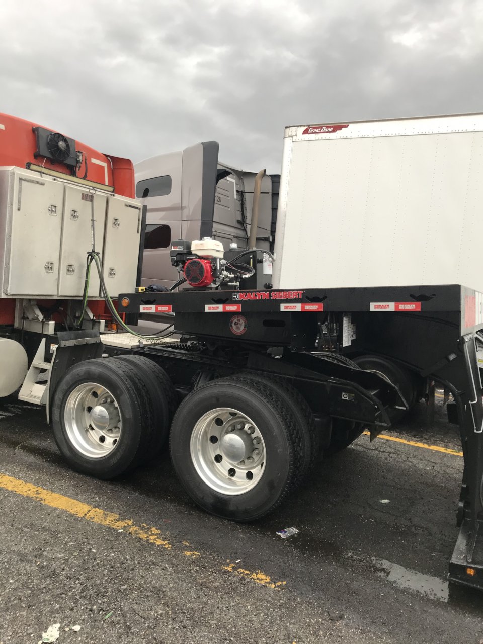

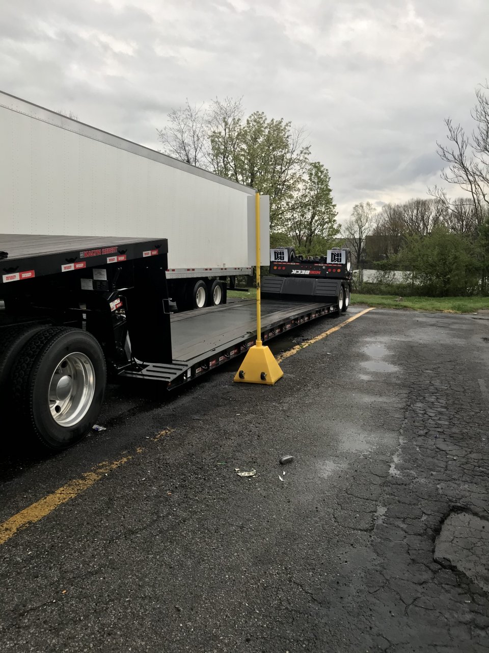

    Ok I just picked up new trailer...... a buddy of mine mentioned getting 5th wheel risers because of the way it sits on my 5th wheel..... is there a reason for getting 5thwheel risers other than that...? 7C67A399-5C38-4F41-9F75-7B38EF5A5B21.jpeg EB20C39F-C9EF-4374-8D28-E9CC927D2EBD.jpeg

    The deck looks to be riding about 4 or 5 inches above the road while empty.
    If that is not an illusion then you will find ground clearance a problem when loaded heavy.
    Larger tires may help but used taller risers may be more economic especially if your 5th could use a rebuild.
