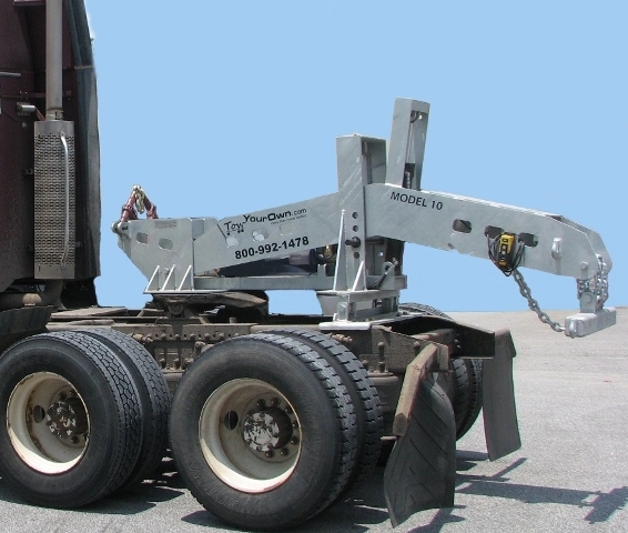

    Maybe. It seems weird but you see guys going with those lift & tow gear setups in their frame pinned into the hitch. They are chained and have lights but I’d say not much different. 25CDFA11-3F96-4249-BAB5-5E0ADFEA2E1E.jpeg
    D.Tibbitt Thanks this.
