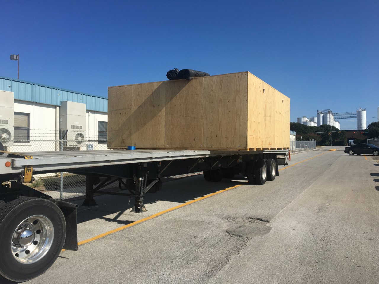

    You don’t need pull outs for crates. We haul 16-20’ wide loads all the time on flats and obviously don’t have pullouts or out riggers.

  6. RollinThunderVet
    RollinThunderVet Heavy Load Member
    717
    970
    Well duh, but a wider base is always more stable. I've haul 16 wide on my step. But that wasnt my question. I'm more looking at 80k pieces or a tracked piece that is 11 wide and hangs over the deck weighing 80k.

  9. kylefitzy
    kylefitzy Road Train Member
    4,755
    19,811
    Aug 12, 2007
    Kansas city,Mo
    The only way outriggers of any sort would make a load more “stable” is if the crate was very flimsy.
    A wider base is more stable but outriggers and pull outs do nothing to widen your base. You would have to make your axles wider to make the load more stable.
