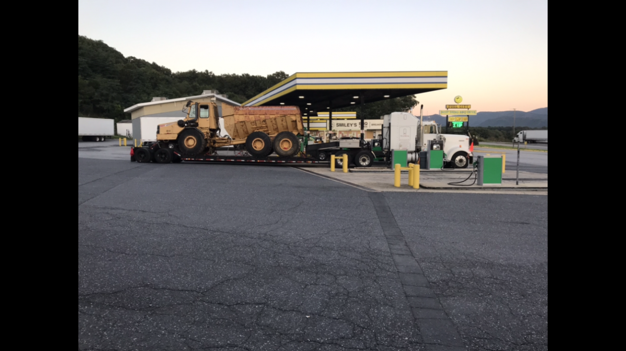

    I bought my 35 ton lowboy from the company I use to work for. It use to have a covered deck on the rear, which made it nice for carrying loaded pallets and the such. I hauled our 312 Cat excavator with no issues and could handle a slightly larger machine with no issues as far as room......
