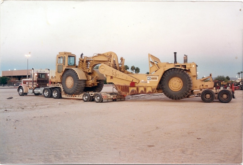

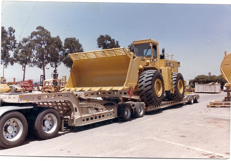

    I hauled many loads 80K to 84K in Calif with a 4 axle tractor and a 3 axle RGN,, my RGN was a stretch and my empty weight was 54K,, axle space was 18'4", 5', 5", 33', 5', 5' closed
    Calif will permit 60K on a tridum depending on axle spacing ( 140K gross), Calif will alos permit a flip axle down and the king pin to rear axle over 40ft if on the permit app you specify the axles down for weight distribution,
    AZ will allow up to 140K gross on a 7 axle set up on I-40 and I-10 on thru loads with a class C permit.
    bought at the port of entry,
